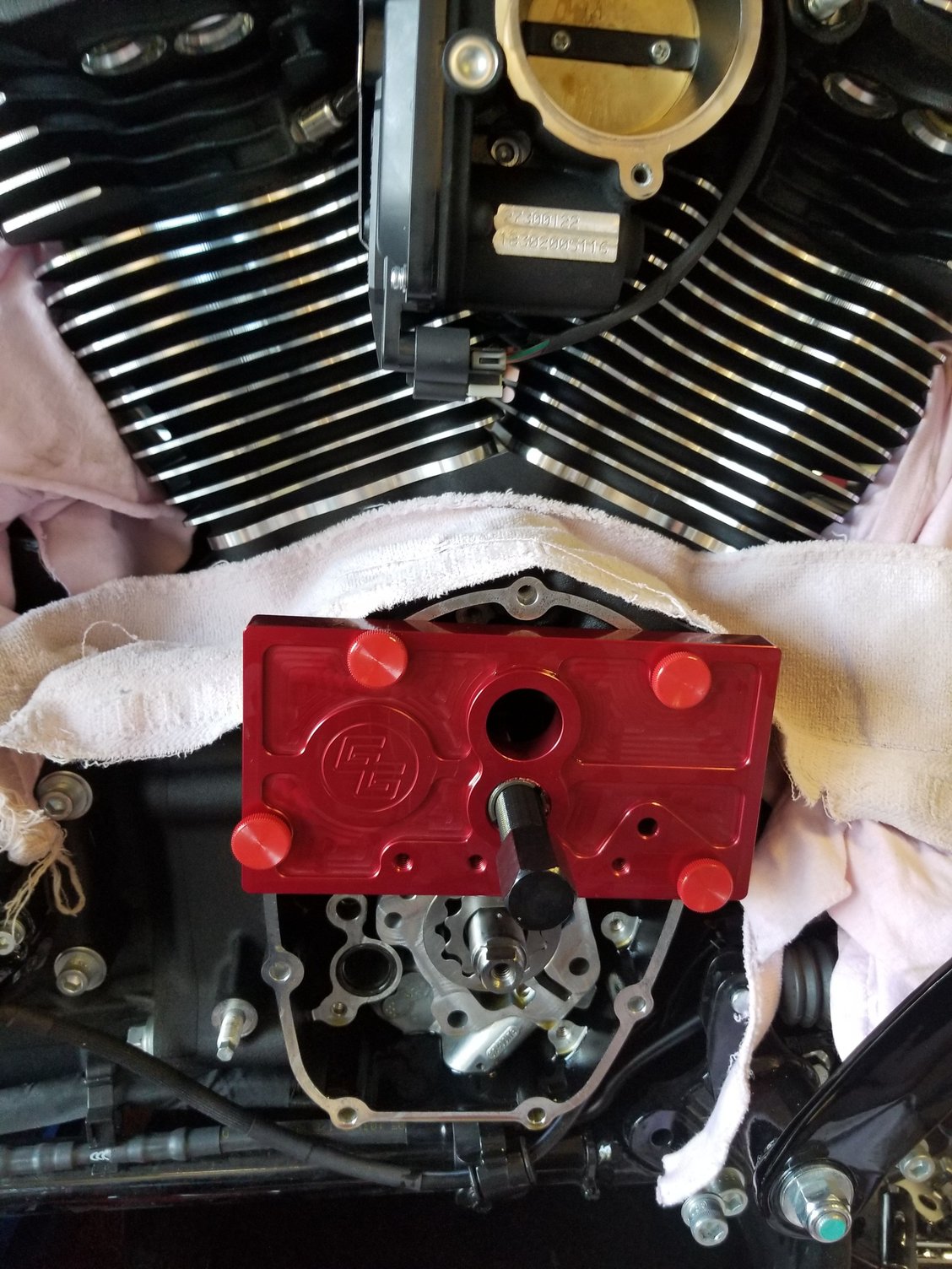

So I cut the pushrods, bought the black lifter blocks and tubes, bought George's install and removal tool for the bearing (awesome by the way) and endless other goodies. I bought all parts from Fuel Moto. The cam is the Woods 22X. Everything taken apart, bearing pulled and installed, torqued cam plate back on, tried to turn the cam, no bueno.
Took everything back apart, up on further investigation the stock cam has a lip on the bearing journal that goes into the case, the Woods does not, so it slides all the way in and the first lobe hits a case support. Guess I will be on the phone first thing Monday morning.

When you put your gear and chain on it will keep it pulled out to where it will turn fine

I know with the older single cam Evo motors to go over .520" lift on a new cam we had to clearance the case to keep the lobe from contacting. Also had to shim the cam to .015" clearance at the cam chest cover bushing. Not sure if that is an issue with the M8 but I'm sure if you called a local indy, he could give you the skinny on it all... Don't have to wait till Monday.....

+1 On this. Thread the cam gear bolt into the cam a little and the pull it forward. It will turn without issue. I had to leave the bolt (without washer) on there so I could get the gear on it as well.

You are the man RDC. Works great and the cam is awesome. Just have to figure out why I cannot get the idle below 2000 rpm. Tuner says it should be good, but no matter what I do it does not change much
