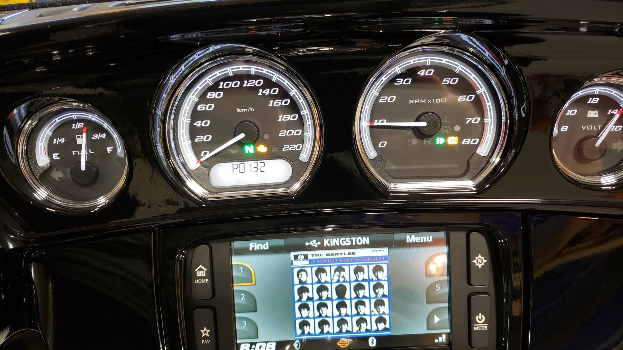

Here's the latest, got the bike back from getting the SE exhaust put on and the dealer said it needed to be tuned so I said ok but don't screw up the tune I drove 8 hours to get done at another dealership two or three weeks ago. Got the bike back on Friday July 27th, took it out for a run on Sunday... sure about 50km out the check engine light triggered, oh ya I was happy... So I was hoping due to the beat down the tuner would have put the bike through that maybe there was some residual something that caused it to trigger so I reset the ECM codes and took the bike out last night for a run to see what would happen, yup at 48KM the light came back on, pic attached.
Got back pissed and deleted that tune and loaded the TTS tune, Steve has said that the TTS map should be close but each bike is a bit different so a good tuner should be able to dial it in. After loading the TTS tune in I went out for another run, did a 79KM loop with no issues, pic attached
Code P0152
Code P0132
TTS Map, no codes
