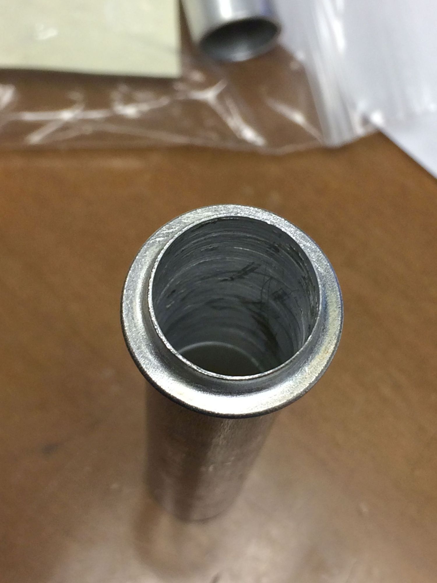

Back in the day, boring the top and bottom of the pushrod tubes to eliminate the crimped shoulder that reduces the ID of the tube at the top and bottom was done to provide more room a those two points of the pushrod travel to eliminate contact between the pushrod and tube. Findind a machine shop to do the boring is cheap and quick as DIY fixes usually resulted in trashed tubes or injury. However, I did see one DIY approach used that made some sense. The guy used uni bits in a hand drill at low rpms and reamed out the crimped area. Understanding the pushrods have to be removed for the DIY fix, replacing with OEM hardware or a custom set of fixed length pushrods would be the better way to go.

Attachment 619422
Attachment 619423
I did my twin cam tubes with a 5/8" reamer I use for truck frame work in a drill press
Just went slow and let the tool do the work
Don't know what size you would need for an evo, but this style reamer comes in many sizes

Originally Posted by Fat11Lo
I did my twin cam tubes with a 5/8" reamer I use for truck frame work in a drill press. Just went slow and let the tool do the work. Don't know what size you would need for an evo, but this style reamer comes in many sizes
Same size for the Evo. What did you use to hold the tube? I found that to be the hardest part.

with the drill press I just used my left hand to hold the tube
square the deck before starting
slow and steady pressure let the reamer do the work, it will get warm take breaks to let it cool
The unibit scares the hell out of me seems like it would want to catch easy, this type of reamer makes better contact and the taper is gradual, see how smooth the finished tube is compared to one of the previous pics
with the drill press I just used my left hand to hold the tube, square the deck before starting. slow and steady pressure let the reamer do the work, it will get warm take breaks to let it cool
Agreed, the uni bit is touchy which is why I was asking the question. Welder, air compressor, hydraulic press, table lift but no drill press here although I have been thinking about getting one so I will have to come up with a work around.
