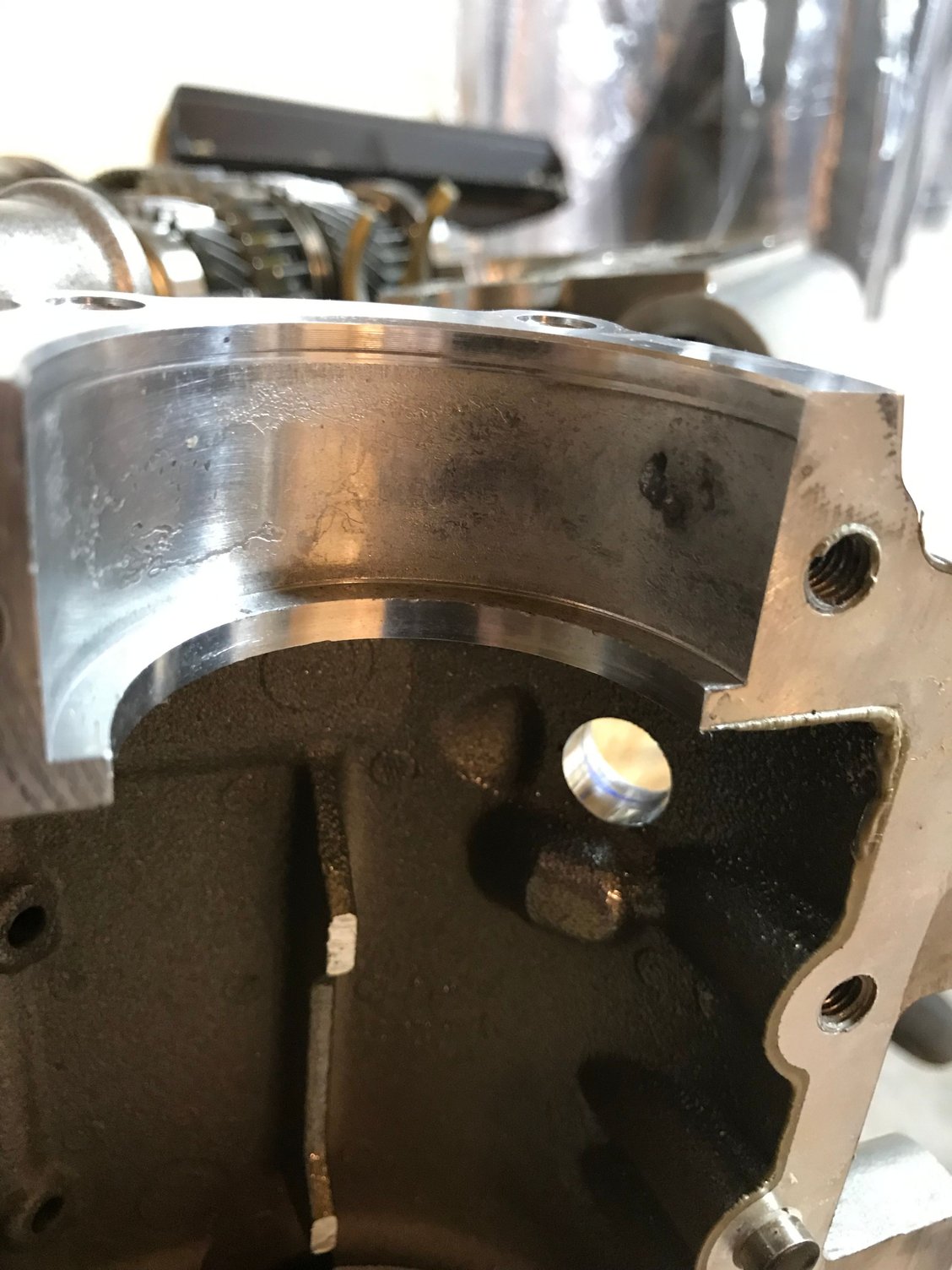

The output bearing on the transmission went and sent debris through the engine. I haven't seen it yet, only photos. They are bringing me the bike back today so I'll have it in my garage now to deal with.

I figured parts may get a bit scarce. I need to know now if this damage is too much to ignore
Bottom end - output bearing cavity.
Top end - output bearing cavity.
is damage to the casing is too much to ignore?

Don't know much about V-Rods but I would take it to a machine shop and see if the case can be cleaned up (bored) to receive an oversized bearing.. I'm sure there's an Indy out there that can do this if there's an oversized bearing available.... What other damage to the motor is there?

Doesn't the bearing in that location run in a race?
Did the bearing seize and spin the race in the engine case?
