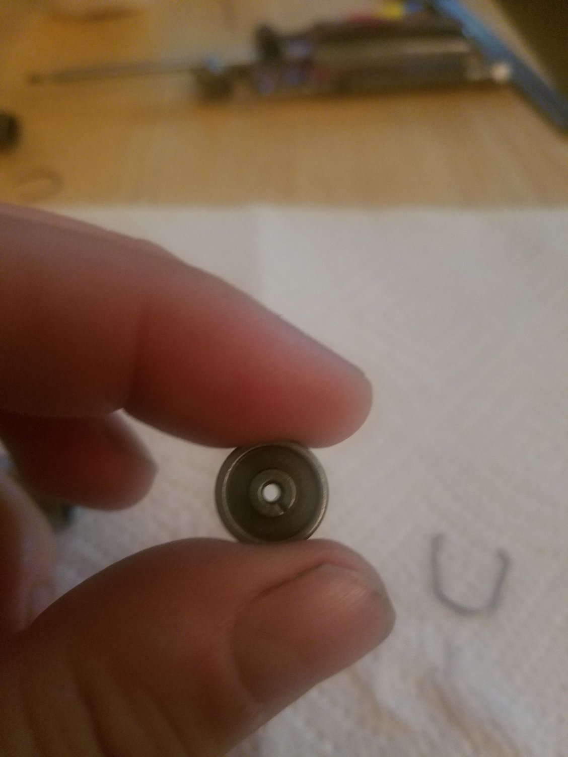

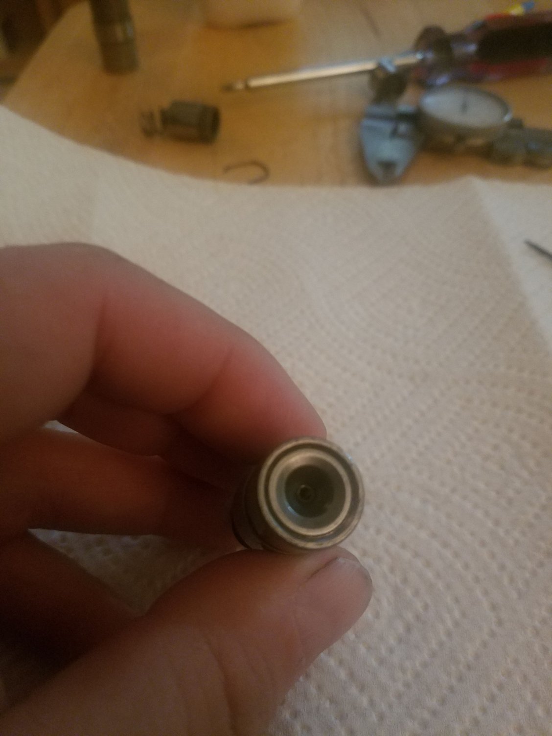

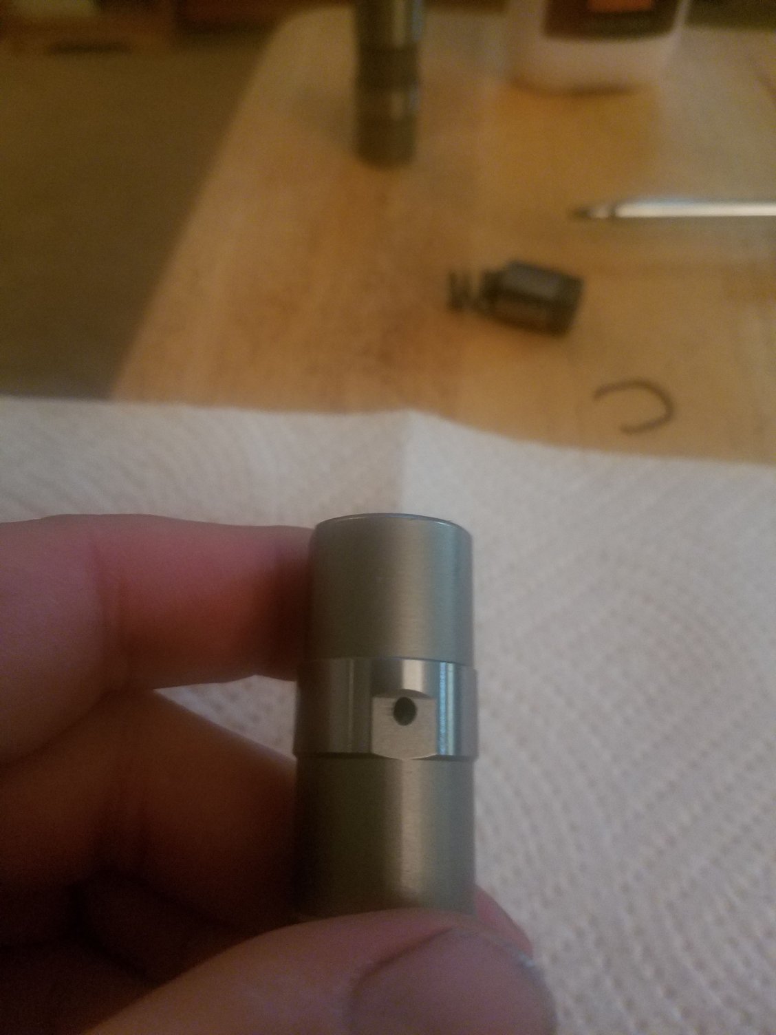

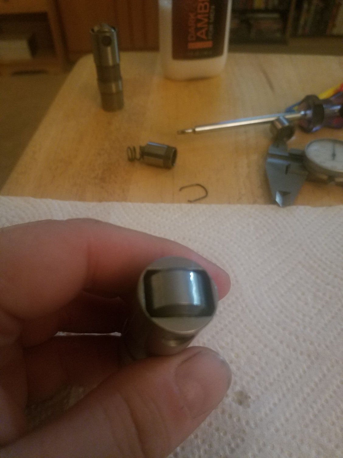

onto the Crane 10530. Here is an exploded view
main body oil hole. .100"
internal plunger, oil hole .092"
bottom view of pushrod cup. this one measured .078", but could potentially be enlarged
metering disk in place in plunger
pushrod cup sitting in the plunger
axles on these are swaged in, and not going anywhere. No chance for a c clip to break and screw your case
roller axle is slightly smaller diameter, and as such the rollers are further inside the lifter body.
