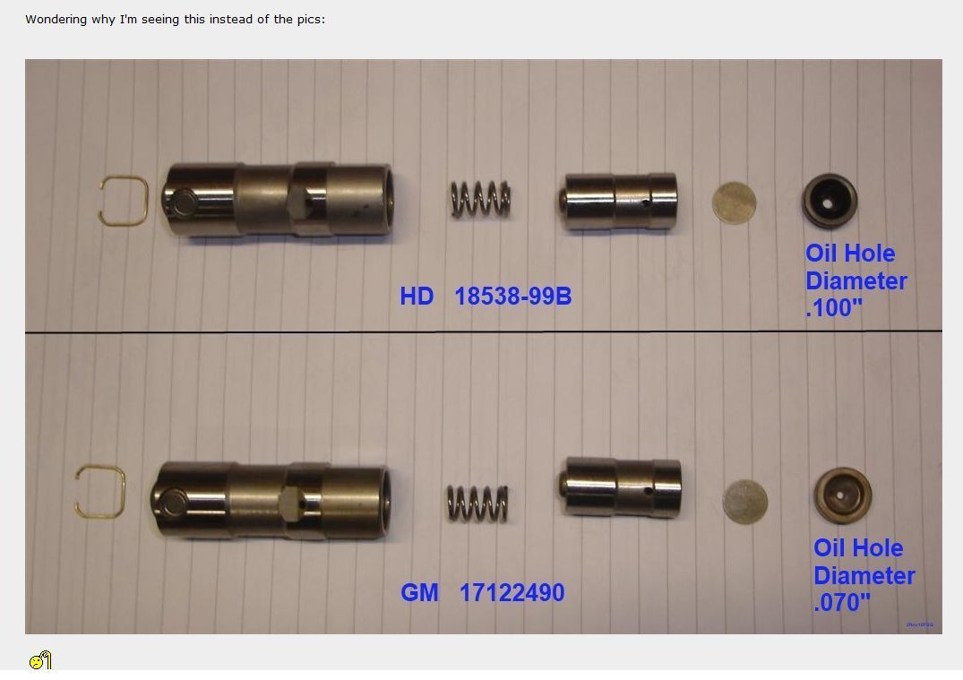

Note the difference in the orifice in the piddle valve and that the 'B' lifter has a larger opening; not throwing shade on the GM lifter but pointing our a difference. One has to remember that the HD oiling system relies on volume and flow, unlike the GM system relies as much on pressure to distribute oil. IIRC, the S&S Premium lifters are also made in the USA; seems to be some debate on the Standards though regarding source of supply.
yep, seen this pic as well. Don't yet know what the Crane lifters will have for an orifice size, jor what the matching orifices size is on the stock fixed length pushrod. I DO plan on measuring both though. If I feel it's appropriate, and the stock lifters have the larger size orifices (c spec in there now with no top end oiling issues) I'll drill them out.
also, I am doing the bypass upgrade, so flow, along with pressure should not be an issue. That brings up the last issue I had with the S&S video, it was only tested at idle of 1000 rpm at 175 degrees oil. What are the characteristics of both lifters at 2000 rpm at 32psi (harley oil pressure spec). My engine spends a shitload more time above idle than it does at idle. Again, not saying anything bad about their products, if this was a no holds barred build, theirs would likely be going in. This is a refresh of a 100k mile motor that is bone stock. As long as the chevys meet factory flow characteristics, and don't sound like rocks in a coffee can, I'm happy.
