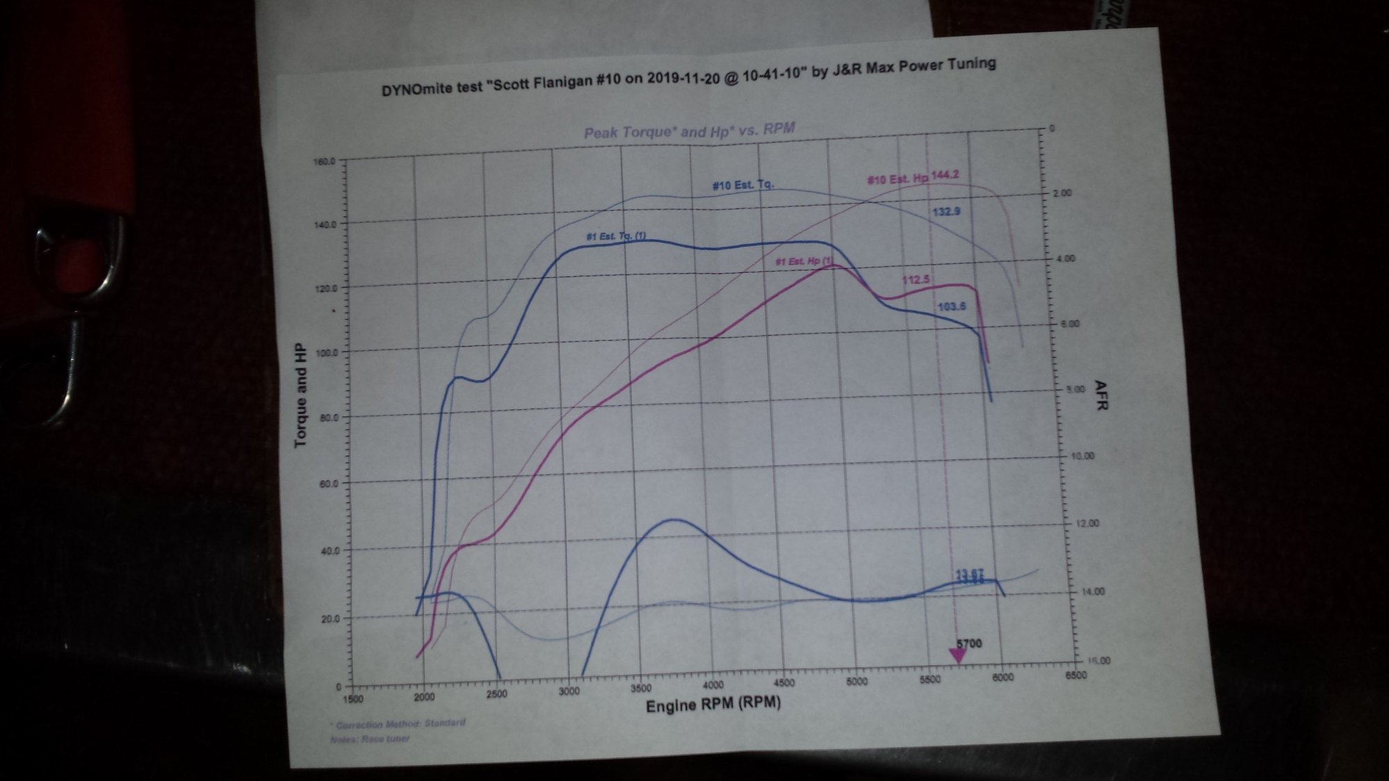

My motor has TW-9F-6 cams. Rush Wrath exhaust . HD Race Tuner.
