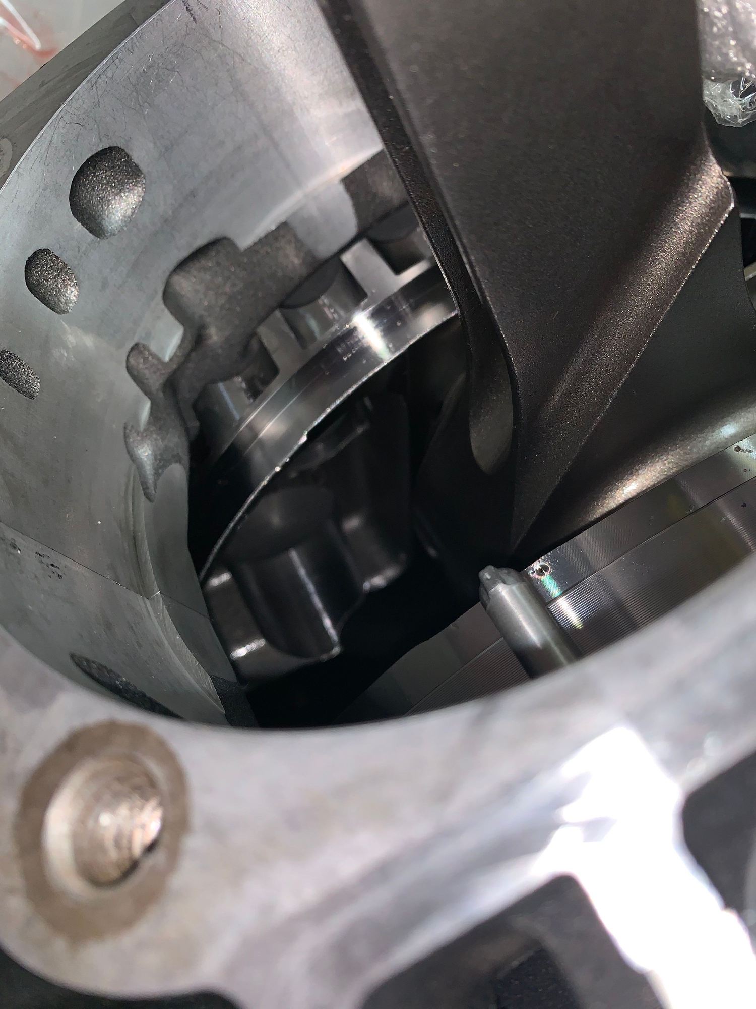

Intakes are at 315 cfm @ .700" exhausts are at 240 cfm @ .700". He was hoping for a little more top-end flow out of the intakes, but didn't want to sacrifice any mid-range flow. Today the compression will be set at 12:1.
Here's a pic he sent today.

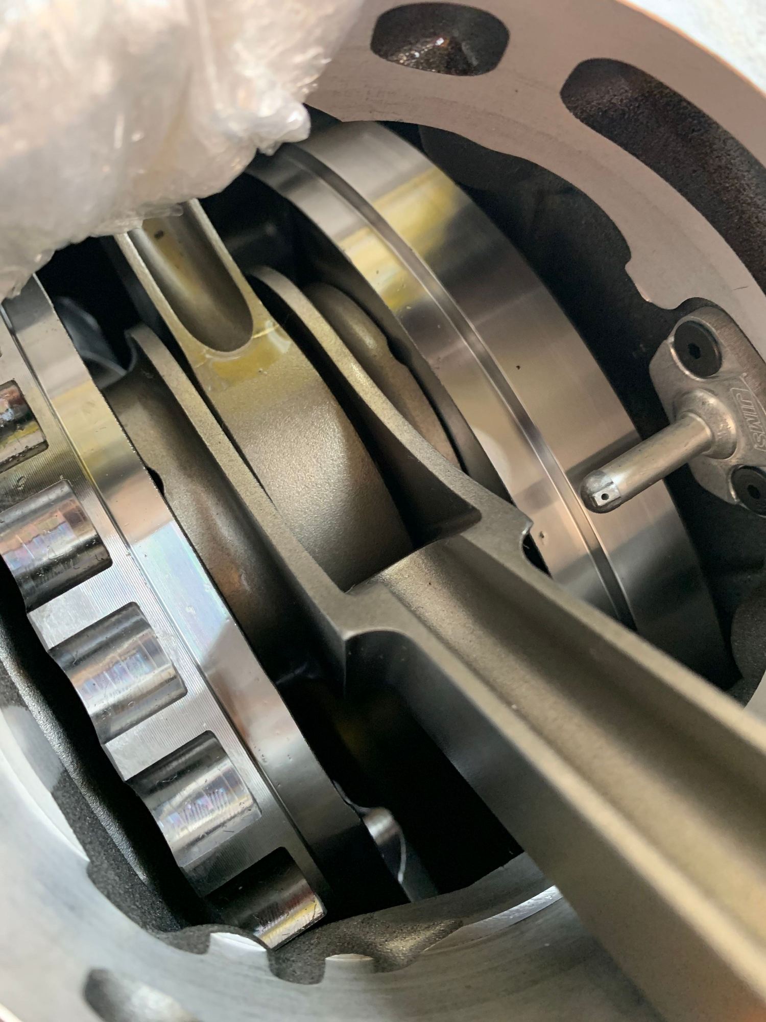

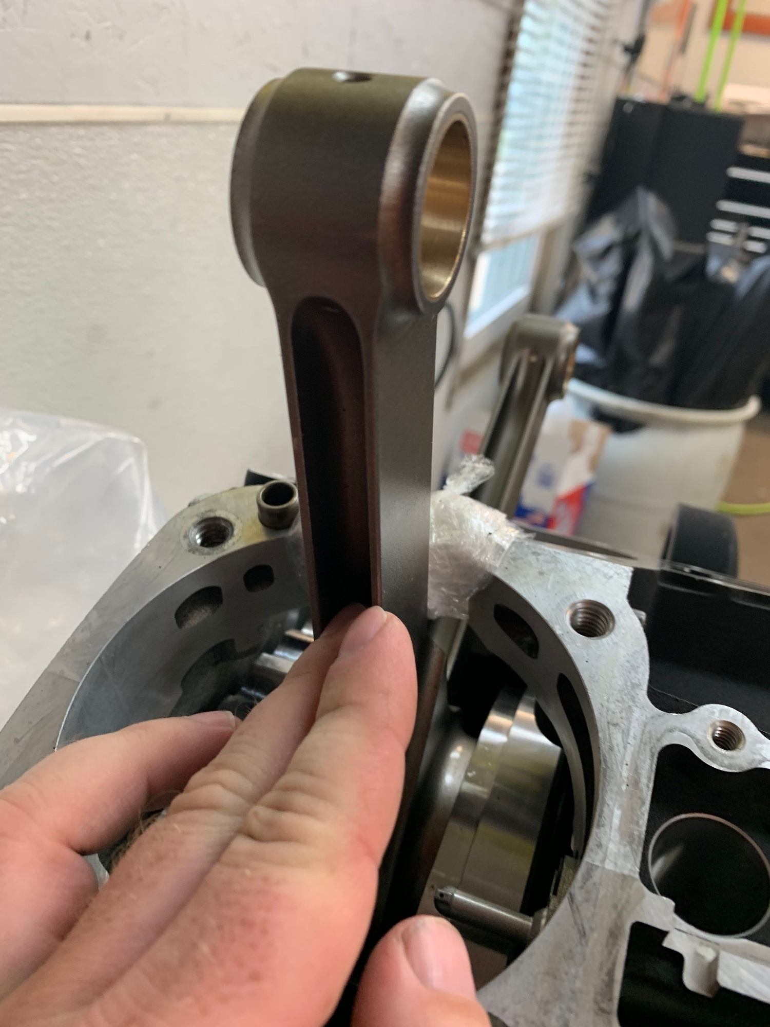

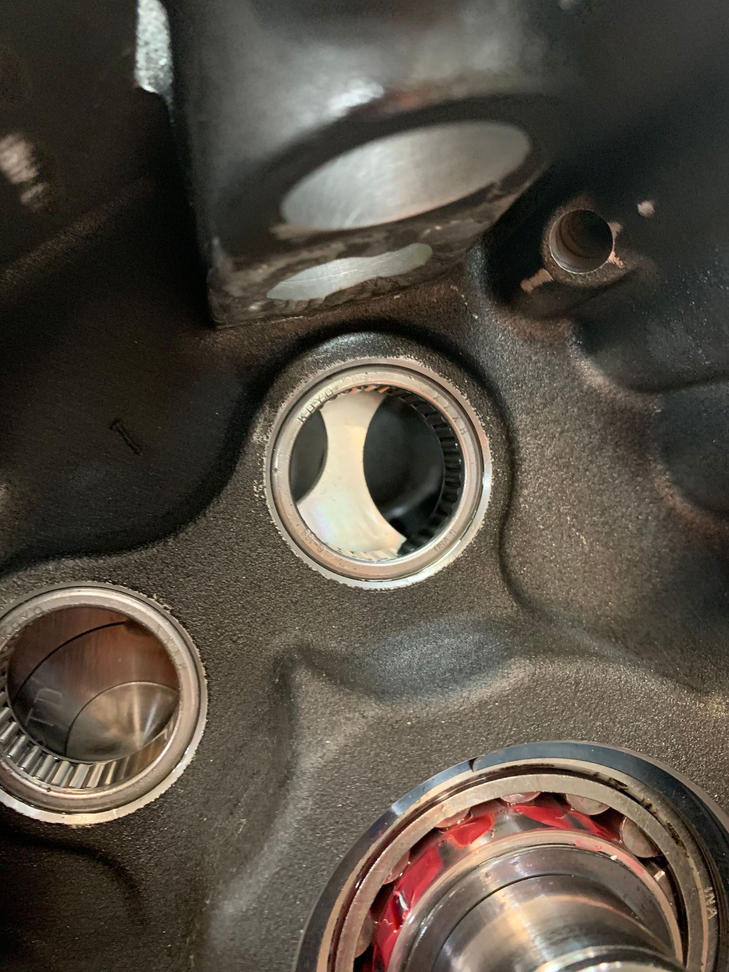

Been a while since an update, this covid bs really put a damper on things. Anyway I snapped some pics of the darkhorse bottom end prior to the engine assembly. They pulled a little weight out but not enough to decrease the street manners enough to really notice.

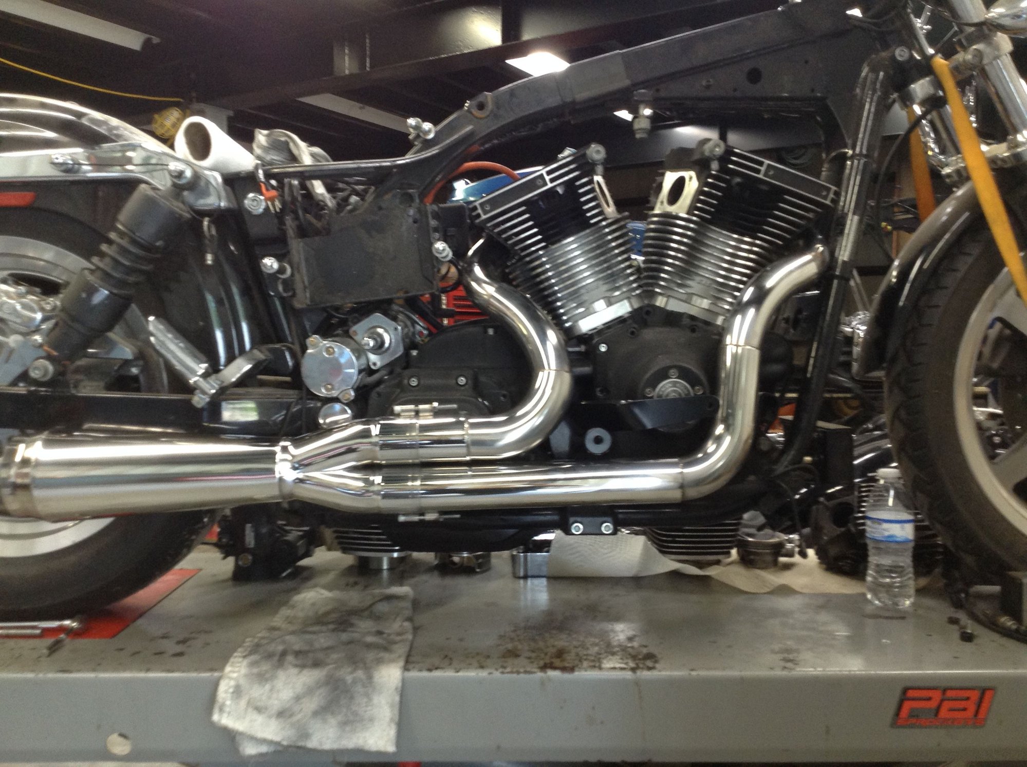

Exhaust is done, just needs to be final polished shipped to me. 1-7/8" off the head, quick step to 2", then 2-1/8" to 2-1/4" into the collector. I am VERY happy with how it turned out. Luckily it stops before the rear axle, should make for easy tire changes.

Curious how you determined where to put the steps?
