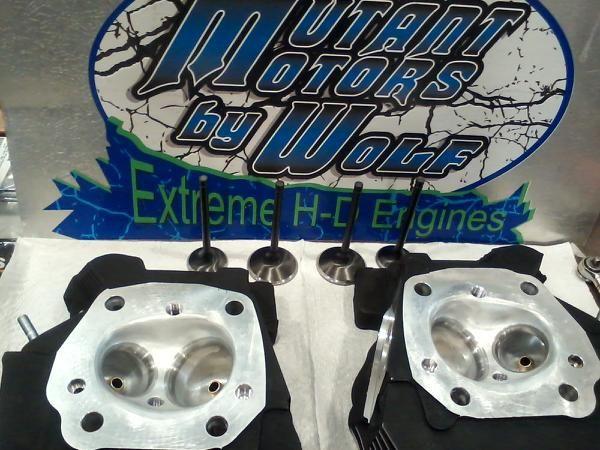

Intakes are at 315 cfm @ .700" exhausts are at 240 cfm @ .700". He was hoping for a little more top-end flow out of the intakes, but didn't want to sacrifice any mid-range flow. Today the compression will be set at 12:1.
Here's a pic he sent today.
intake flow is very low,on our regular 124 street builds we`re seeing at least 325 out of our 2.100/110 heads (330+ on street/strip motors) also build many 2-1 burns collector pipes over the years.how are you measuring for equil length? we would fill the pipe with water & make sure they both hold the same amount,simpyt measuring them with string or a tape measure dosnt work
Steps were done by volume with water. the headers are not equal length, but tuned considering pressure losses through the bends on the rear head pipe. I do agree with the lowish flow rate on the intake, the flow was slightly compromised from the valves being sunk in the heads to accommodate the potential .276/.220 TDC lifts (might run a 1.725 on the intake).

I wouldn’t sweat the flow numbers. Wolfgang knows how to make power, set up proper pipe length steps based on motor needs, and I’m sure he also knows, flow numbers are just a tool to evaluate the heads, with VELOCITY being number uno. My street heads flow a bit north of 400 on the intake, but remember.....we are using street bikes on the -street-where a big, sewer pipe hogged out intake hole that flows huge numbers will be a dog driving around town at street compression, moderate, street friendly lift, and pump gas. Gotta have Big Time port speed. V Twins are basically a Pushrod V 8 sliced off, and for heads to Really make big time power, they have to match the motor, valve train, compression, fuel availability, cam profile, type and size of induction system, Exhaust, and how the motor will be used, combined with the honest goals of the owner/rider.......
Anything, anything, off even a little bit in the recipe, Equals less than optimum results. See it all the time, and the end result is a pissed off or disillusioned owner, who was guaranteed “big numbers”, and got far less at the end of the day than they were promised.

Thanks for sharing that article, that was a good read. When I spoke to Wolf about the heads he told me just about the same exact thing as you. Most of his time was spent dialing in the port shape with the velocity probe, making sure the port had no dead spots. The heads were dialed in for what I wanted with longevity being considered as well.
I trust his recipe, as this same setup with his 110 heads, same cam, pipe, and compression made 163hp on his dyno (on 93 pump gas), and put his 700lb Road King in the deep 10s.
