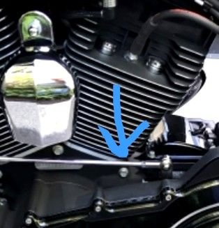

New to just about everything, but I need to remove this same bolt under the rear cylinder on my 2004 Dyna and then put it right back. It's securing a bracket that holds up the unused shifter arm from the mid controls--which I'm re-installing. Any special issues l should know about before doing this? Torque value? I usually try to look up and learn on my own, but wasn't finding anything applicable. Thanks for any advice/guidance! (pic not from my bike)

look fo rthe torque spec for the engine case bolts, that bolt is one of the ones that hold the case halves together.

16 -18 ft lbs for 5/16ths case bolt

Thanks for the replies! So I'm assuming just take it off, throw it back on ... Probably no loctite because of engine heat, just torque it properly?

Basic rules pertaining to wrenching on a Harley.
1) Everything gets Loctite.
2) If it doesn't get Loctite, it gets Antiseize.
3) If it is a long bolt that goes thu aluminum, the shaft gets Antisieze and the threads get Loctite.
That's how I was taught.
Right or wrong? I don't know.
I know it's worked for me for the last 40 years.
That was back in the day when all you needed was a socket set and a 4 pound hammer to fix your scoot.
