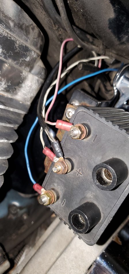

So, now that I'm looking at the actual wiring diagram. Uhm..
He's got this coil on it:
https://www.catalystcycles.com/ultima-single-fire-coil/
Also, I've got a blue wire, a pink wire and two whit with black stripes... I put them the way I believed they were.
Argh!?

Well, regardless of whether it's wired correctly, when I put one multimeter probe on the center post, and the other on one of the outside posts the meter jumps all over from around 160 down to 2 and then will start to settle in around 20 - 3, and finally bounce around between 3 and 3.7.
As I messed around with it trying to repeat the tests, it started not registering at all. Double checked the multimeter and it registers fine on other things still, so I'm going to believe it's a bad coil.
Revzilla and Dennikirk are going to love me before the year's out...
EDIT: Oh, and also, if I put one probe in each of the spark plug towers, it registers nothing as well.

New coil from local bike shop, and she starts!
I now am the proud owner of an at least running 1995 Dyna Super Glide. Fingers crossed I can keep her that way.
