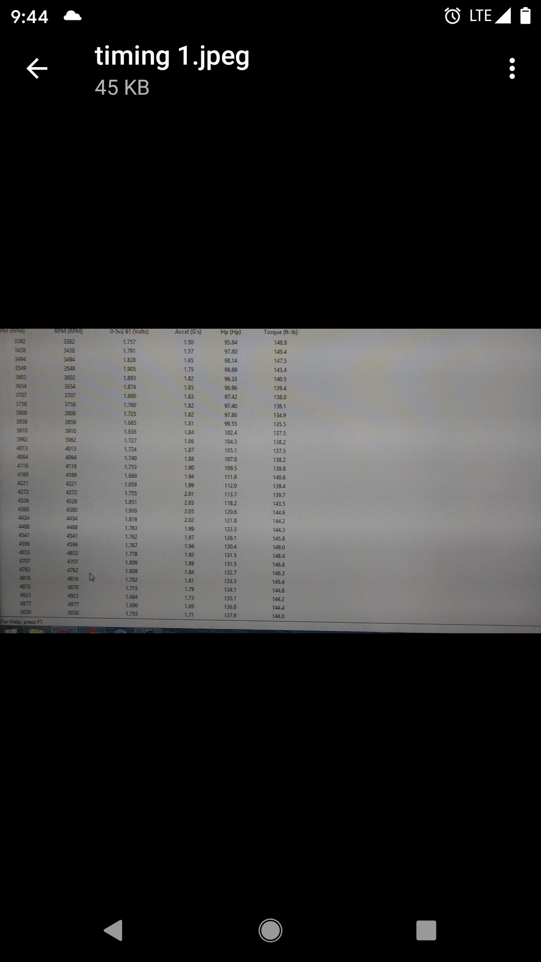

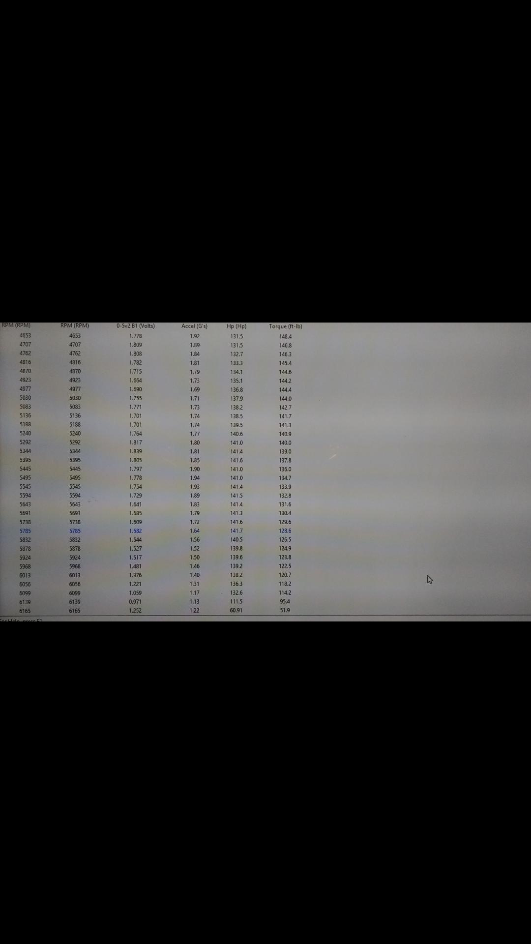

I appreciate all the help and info .. still dragging feet on getting me the Dyno run info.. I have ran across a Barnett non lockup clutch with basket for a decent price.. was wondering if this is a good clutch for my build? Or should I keep looking?

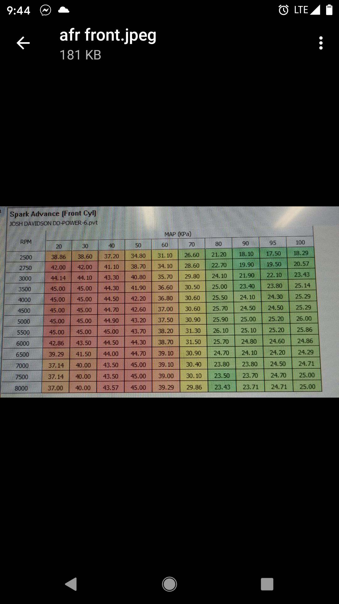

Default Afr and timing
Originally Posted by Hillsidecycle.com
Where the engine is doing the most work, it requires the most fuel.
Could be that simple, unless it is being drowned.
If clutch slippage was that pronounced, then it should have been evident to the dyno folks, and a quick phone call to alert/correct.
Scott
Afr and timing

You need to take the bike to another shop with some better equipment, unless your tuner can convert your 02 sensor voltages into some kind of plotted graph. The timing for that build is also not where it should be, especially if you comp is 10.5 or more. My bet is still on clutch slip. The Scorpian clutch is very cool, just picked one up myself.
