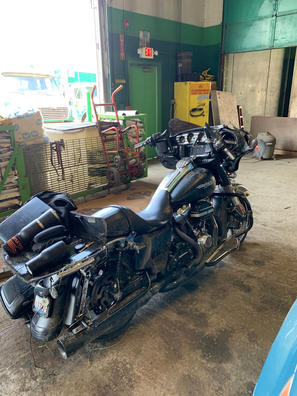

I was doing about 50 mph I would guess and back end hit gas/oil leak that threw back tire into a twister. Ended up going imto a highway culvert. Suffered 8 fractured ribs, punctured lung, and concussion. My 17 Street glide was totaled today and I paid to have it built exactly how I wanted. Now to a new chalkboard. I plan on buying a 2020 and having most of the engine work done before I bring it home. Last bike had stage one power cams with screaming eagle high flow, heads 5 angled by Vance and Hines big bore cyclinders 4.075 and big bore pistons. It was right at 125 hp/125 torgue but held that 100lbs of torqe for close to 3500 rpm range. I looked at the 117 to 131 and am not impressed buy how short the power peak lasts so I’m reaching out for suggestions.
