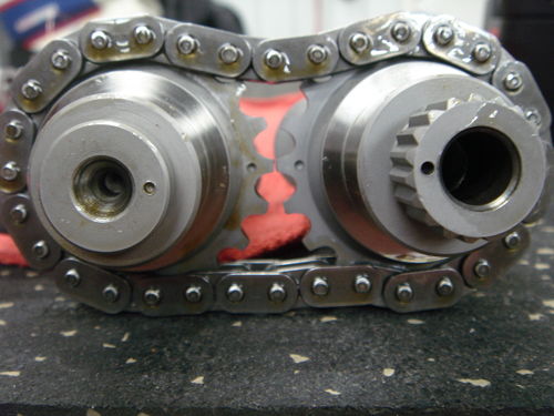

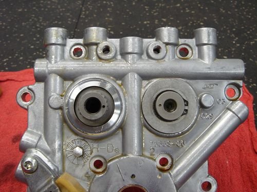

Helping my cousin over the weekend on his 1999 Dyna to replace cam chain tensioners. I can not find any marks on the cams for back chain timing. There must be something there but I am finding nothing more then 3 lines on the outboard end of the cams looking like a PEACE Sign. Any ideas where to look for what I am missing? Also, if there are none, what can I look for on cam profile to get it back together without buying a new set of aftermarket cams?

Throw up a pick of your cam. The marks should look like this.

Oops I thought 99s were evos.
Try this
Or this

I would add a pic but there is nothing to see....
Yes those dots are what I expected to find but these cams have no marks except for the peace sign on the inboard ends. I also found online another instance of a similar situation in a similar year Dyna. He eventually found faint traces of a squiggly line which is what I will look for next.

We had to remove the cams to install the tensioner (clock spring) I did find the squiggly marks but only out in the sunlight tilted at the right angle. Filled them in with red marked and reassembled.
