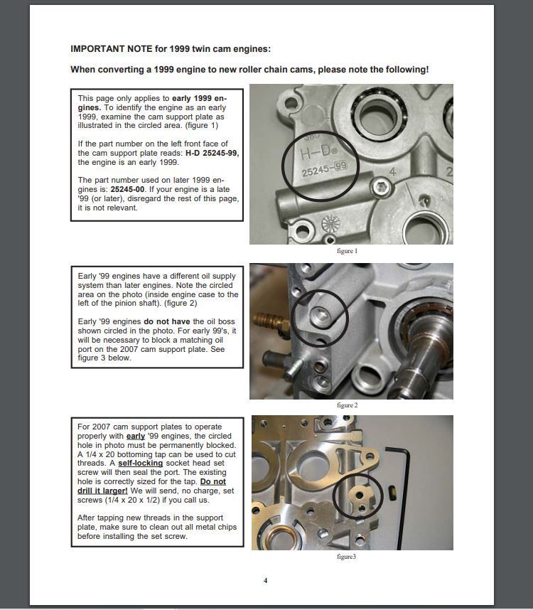

On a 99 TC, did you plug the hole in the cam plate?
The oil hole to the tensioner? Yes I did. The kit came with cover plates.
Old Jul 5, 2021 | 09:28 AM
Max Headflow's Avatar
Max Headflow
Joined: Dec 2005
Posts: 19,899
Likes: 8,006
From: poway
Is it the holes to the softail balancer tensioners or the holes for hydraulic cam chain tensioners? IIRC it's about 1/4" and takes a self taping screw. Cover plates sound like cam chain tensioners.
Old Jul 5, 2021 | 10:02 AM
djl's Avatar
djl
Joined: Jun 2006
Posts: 12,774
Likes: 2,606
From: san antonio
This is what Max is talking about.
Old Jul 19, 2021 | 12:37 PM
KK560's Avatar
KK560
Joined: Sep 2015
Posts: 38
From: Iowa
Got the noise figured out. The bolt to the outer cam gear was coming loose. Still having problems with the speedometer needle and engine light coming on and off. Thanks for all the help so far.
