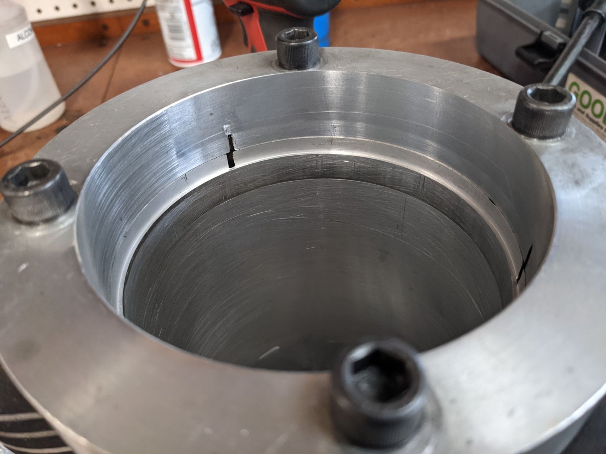

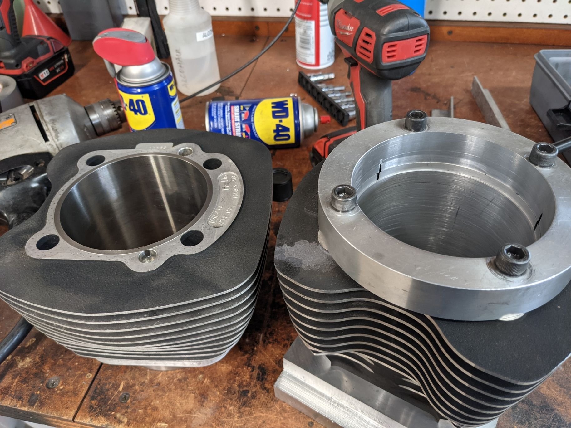

Well things didn't go perfect. I did a minor screw up and stuck the first sleeve. I was still able to get the sleeve out and cleanup marks in the cylinder bore to try again. Second cylinder went perfect.

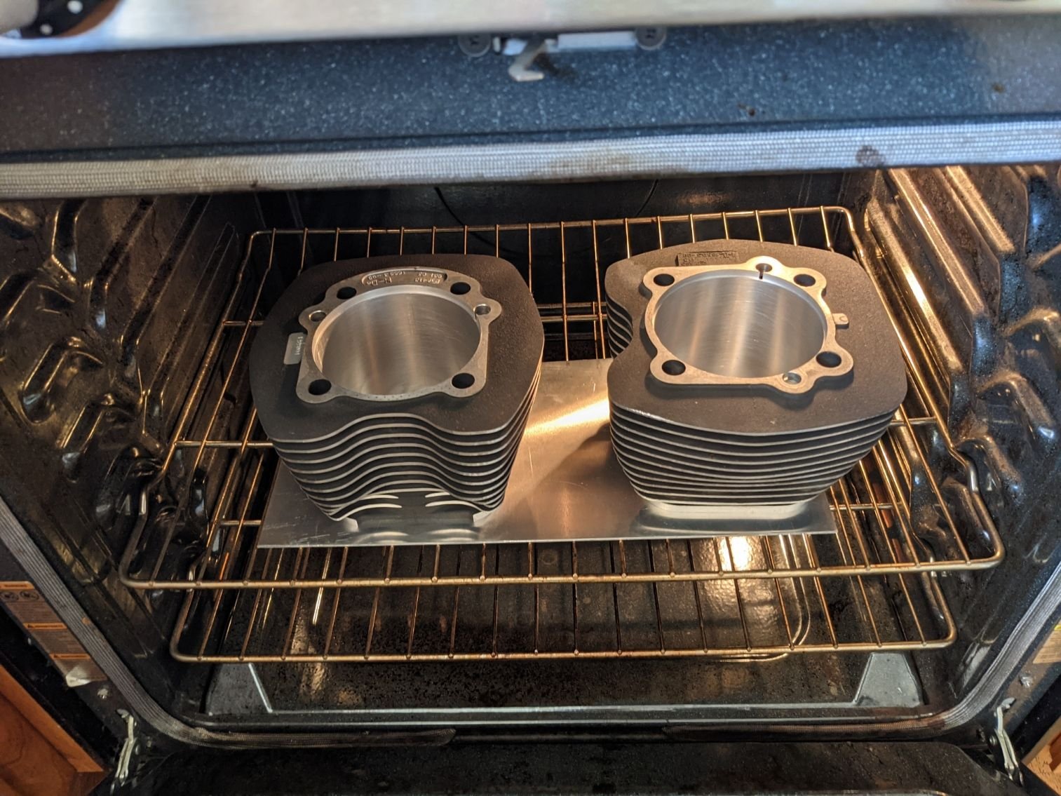

The last sleeve kick my butt. It took 2 more ties to get it in. Third time was the charm. The problem is that the cylinder has to drop in perfectly straight. **** it a little, the aluminum grabs the cylinder and it sticks. I polished the lower inch of the sleeve slightly and rubbed a real light coat of WD40 on the polished part with a towel. I was thinking I'd have to dance around shafking a dead chicken on the next try. Fortunately this one worked. The cylinder got re-honed between each attempt. Still the fit was about 0.0033. Miked the sleeve and it was still round. I used wood this time as I was worried about the aluminum base sucking the heat out of the cylinder.

Fortunately I didn't have to beat on it. It dropped right in as it should. The big thing is the smell from the heating cylinder but by the 3rd heating, it didn't small all that much. Hood fan and select windows with a whole house fan keep smell to a minimum.

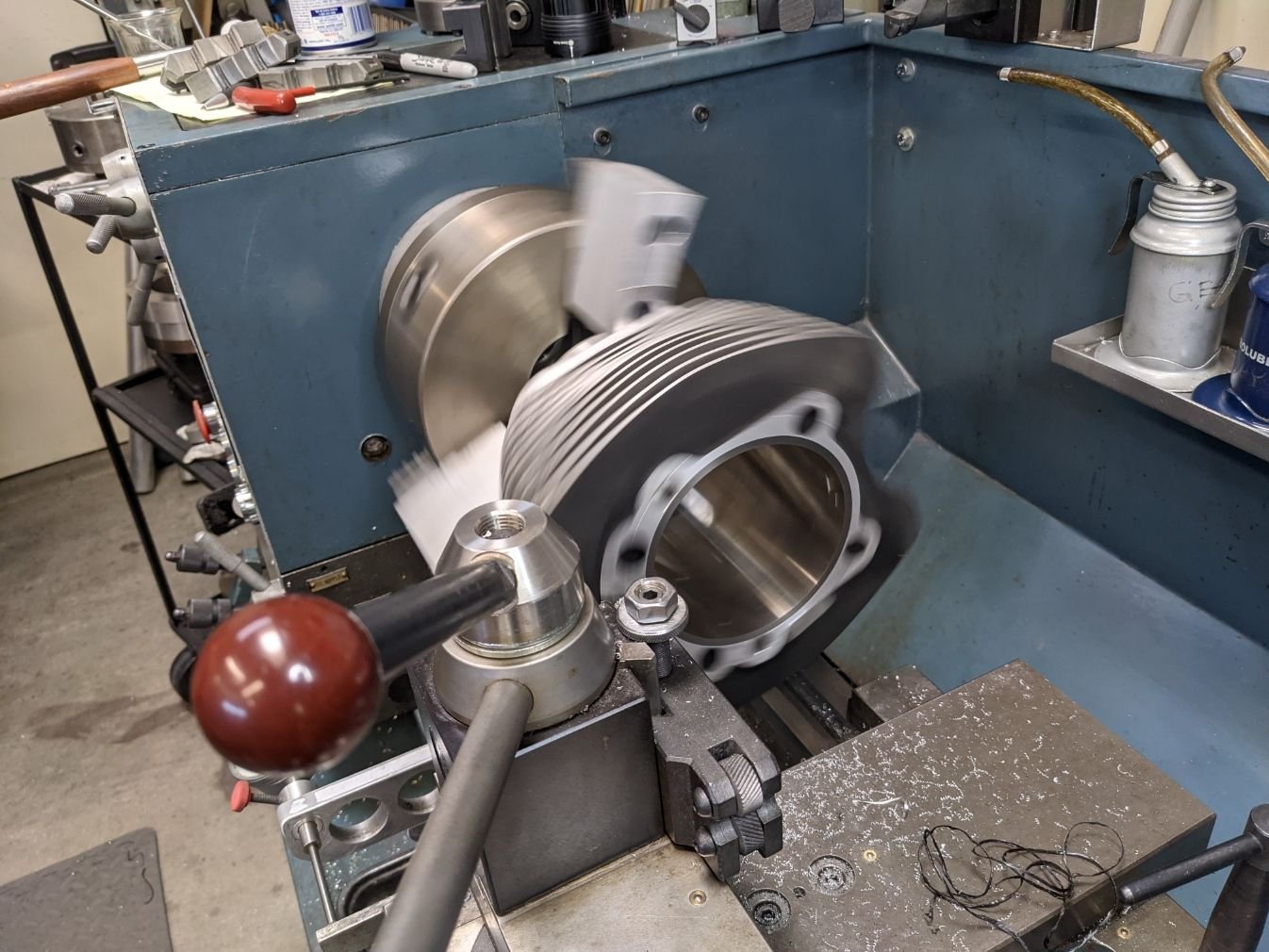

Couple more pics. I screwed up on the final bore on on cylinder and have a new sleeve coming tomorrow.
