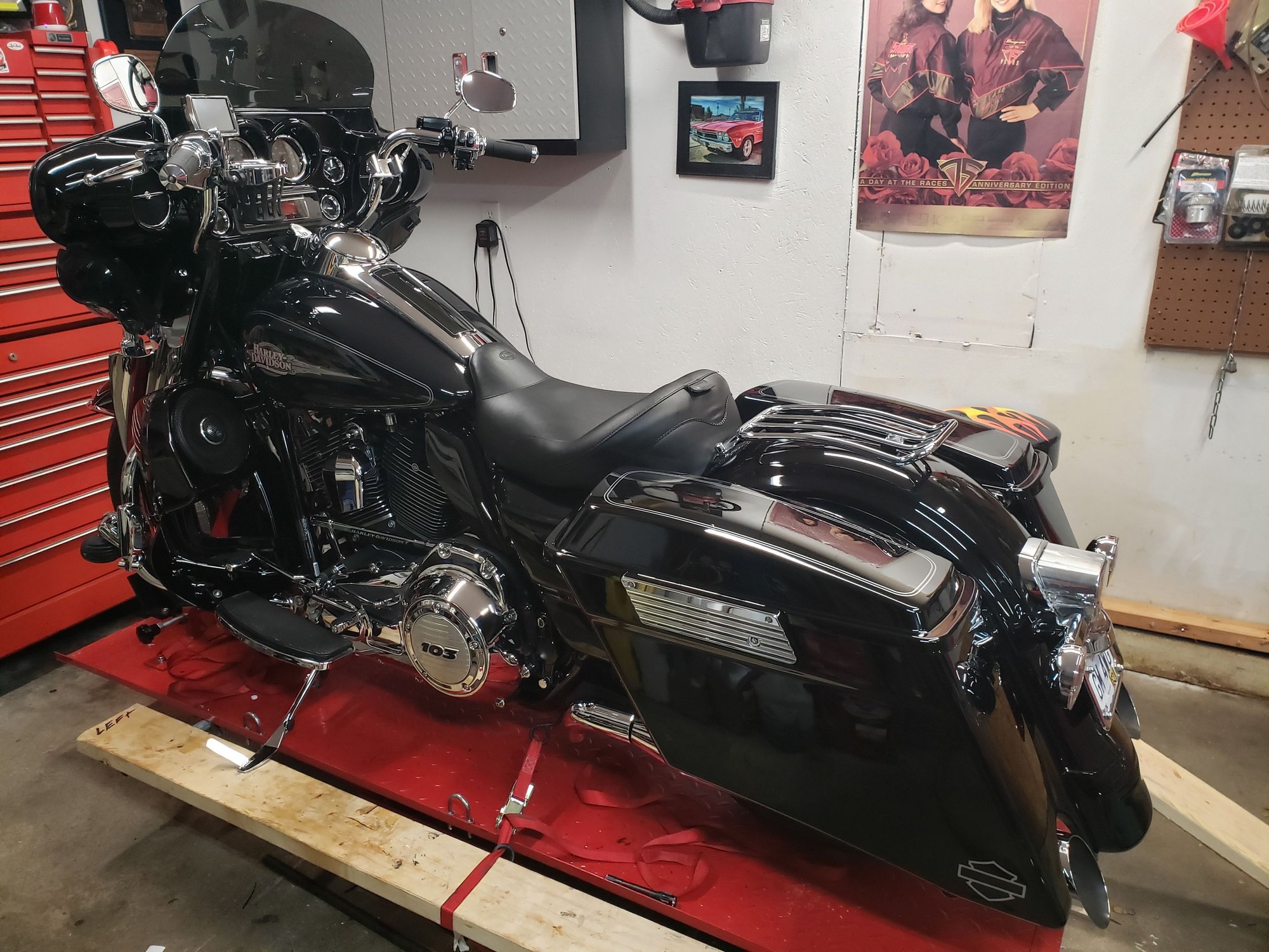

Finished buffing and waxing today! Its all back together and nowhere to go. We got about 8 inches of snow last night!
So about the slipons... They are the Fuel Moto Jackpots. They come with an extra baffle that is supposed to help with reversion. What I understand is it helps with that dip in the torque curve that seems like an issue with some exhausts. I am running an S&S power tune duals head pipe and the Jackpots with the baffle. When I dyno it I could have him try it with and without baffle?
