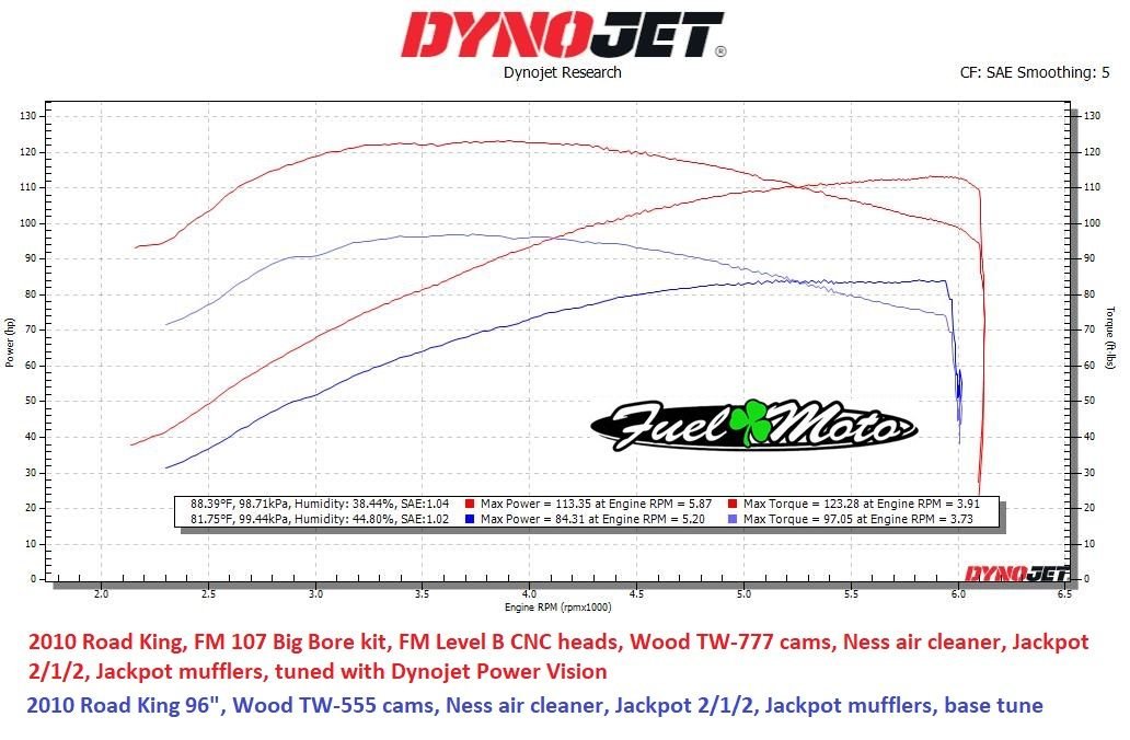

I went from 96 to 107, never considered a 103.
I shipped my bike to Fuel Moto in 2020....zero regrets, it's a lot of fun!
