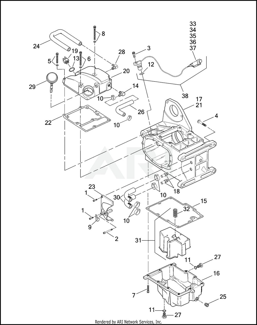

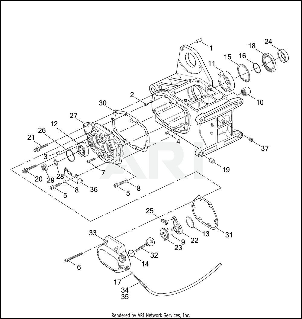

And you own a 5 speed TC.. Look at the diagram CB provided.
Originally Posted by QC
He'll just argue that it's wrong.
I did a 5 speed, 2001, last winter and there was no gasket.
I see there is one. On 5 speed there is no reason to have one. Nothing there, You just bolt the tranny to the engine. Obviously I can see the diagram here.
As for where to get these. You can find parts manuals for older bikes cheap on ebay. I do have one for my 2007. Ronnies Harley also has them online, last I looked a few months ago.

@nutsandbolts5212 All the HD parts manuals with diagrams, part numbers, prices and availability for all years motorcycles are here free for the looking:
Genuine Harley-Davidson OEM Service Parts | Harley-Davidson USA
2001 Dyna's do not have a gasket as they are a different design. See Below.
However, the OP has a 2007 Dyna and there were design changes. There are always design changes.
Models and configurations change over the years and that is why it is useful to those asking questions to provide the correct information. Proper research and knowing what year and model the questions is coming from is useful.
2001 DYNA TRANS & OIL TANK SET UP
Yes I was wrong
I just did a 2001, and did not realize they changed that much.
I even went looked at my 07, that I bought in 2007, and never realized it did not have hoses.
Not that Harley cares what I think, I like old design. Easier to work on.
Again I was wrong. I just worked on 5 speed. But have never pulled engine on 6 speed.
