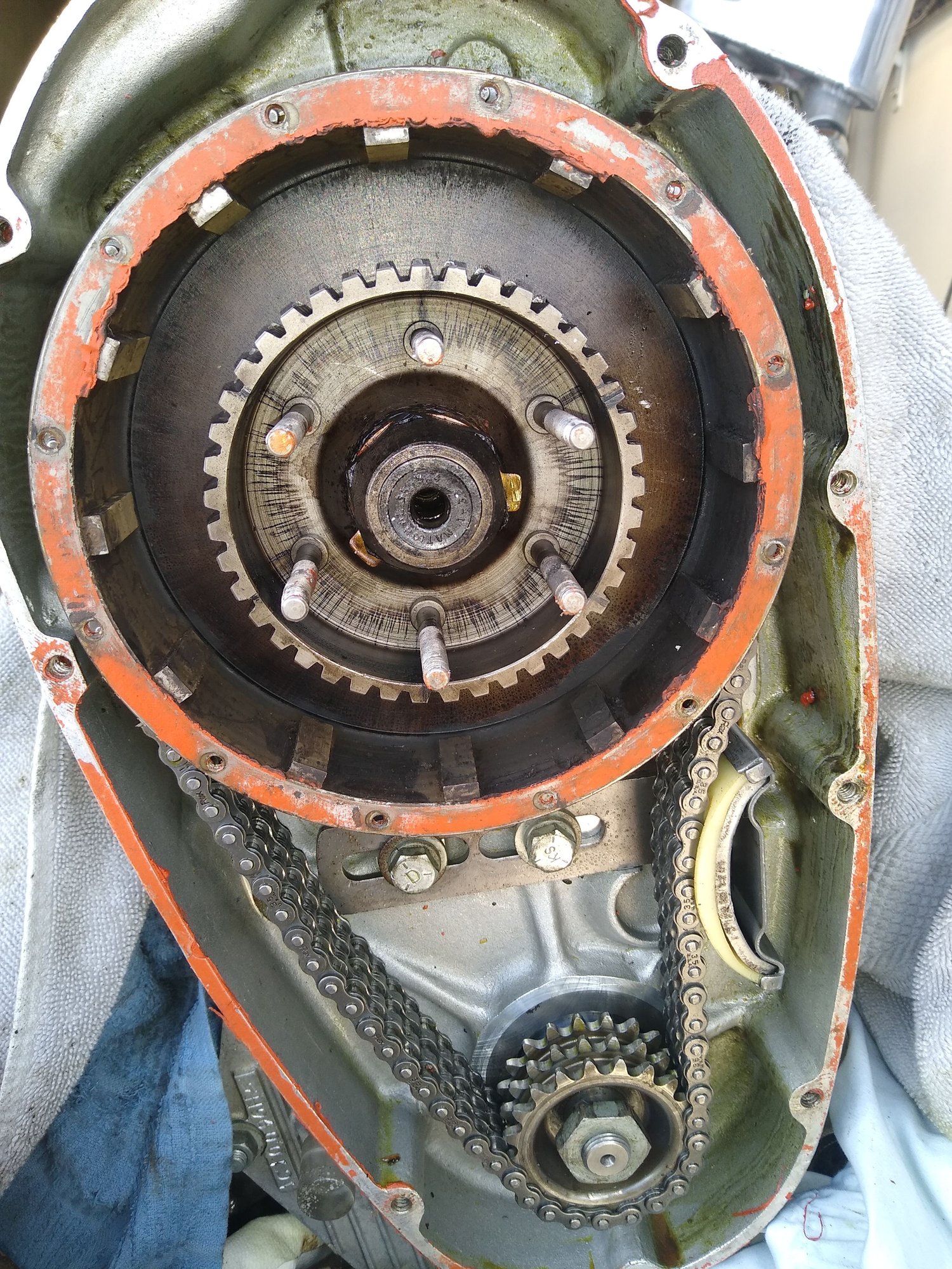

Primary Drive
Primary dr tool

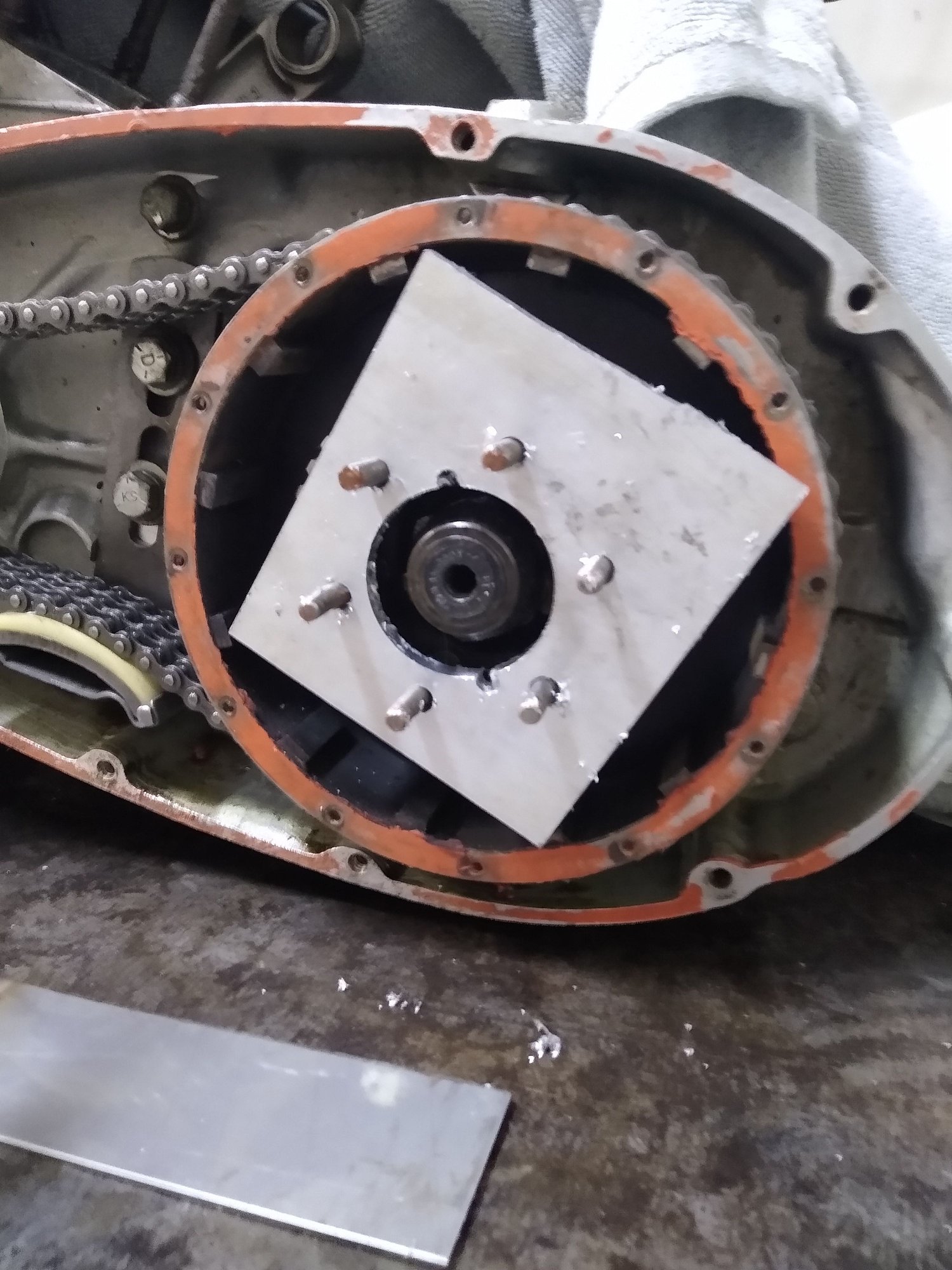

Tool inprogress for breaking clutch nut free
Is there a better way to break the front crank nut free than wedging an impliment between the front and rear primary sprockets/chains. Seems Neanderthal to do it that way.
In-progress in making a tool to hold the clutch center to break 1.5" nut free.

You need a locking bar to wedge in the teeth of the comp sprocket teeth and clutch hub sprocket teeth to prevent the parts from turning. Then a long (36 or longer inch) braker bar with the correct size 6 point socket. The threads are right, so turn if left to remove it.
It's possible someone used the high strength red thread locker (locktite) on the nut when it was last installed. That may require some heat to losen the thread locker (locktite). But try to losen it without heat first. And if heat is required, just get it hot, not glowing red.
If you end up needing to remove the clutch basket, the same locking bar tool works, but the threads are left.

Locking bar in the sprockets is not neanderthal, this process has been used since before we were born (I`m 69).
However, the locking bar isn`t going to help with the clutch hub retaining nut at this point.
Transmission in gear, hold rear wheel, untorque nut.
