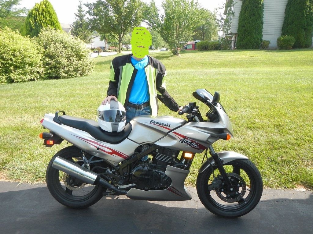

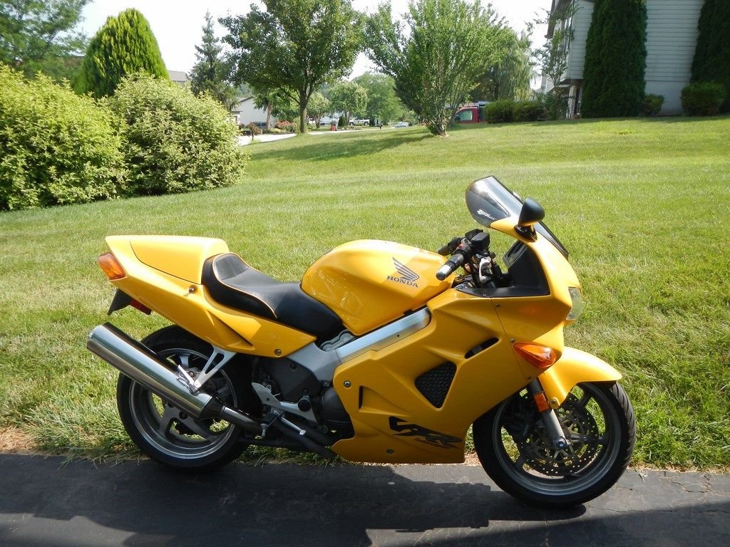

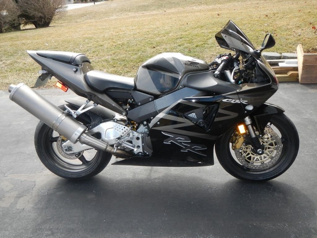

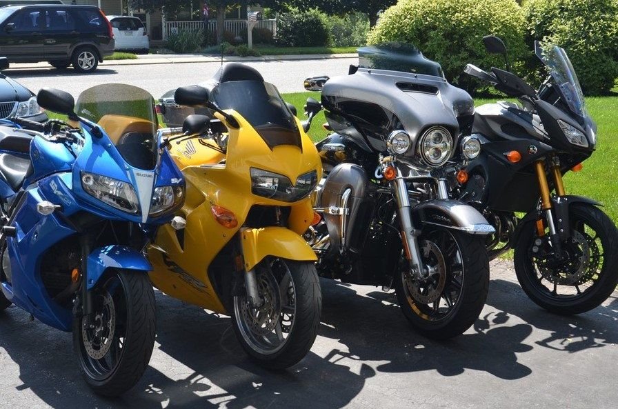

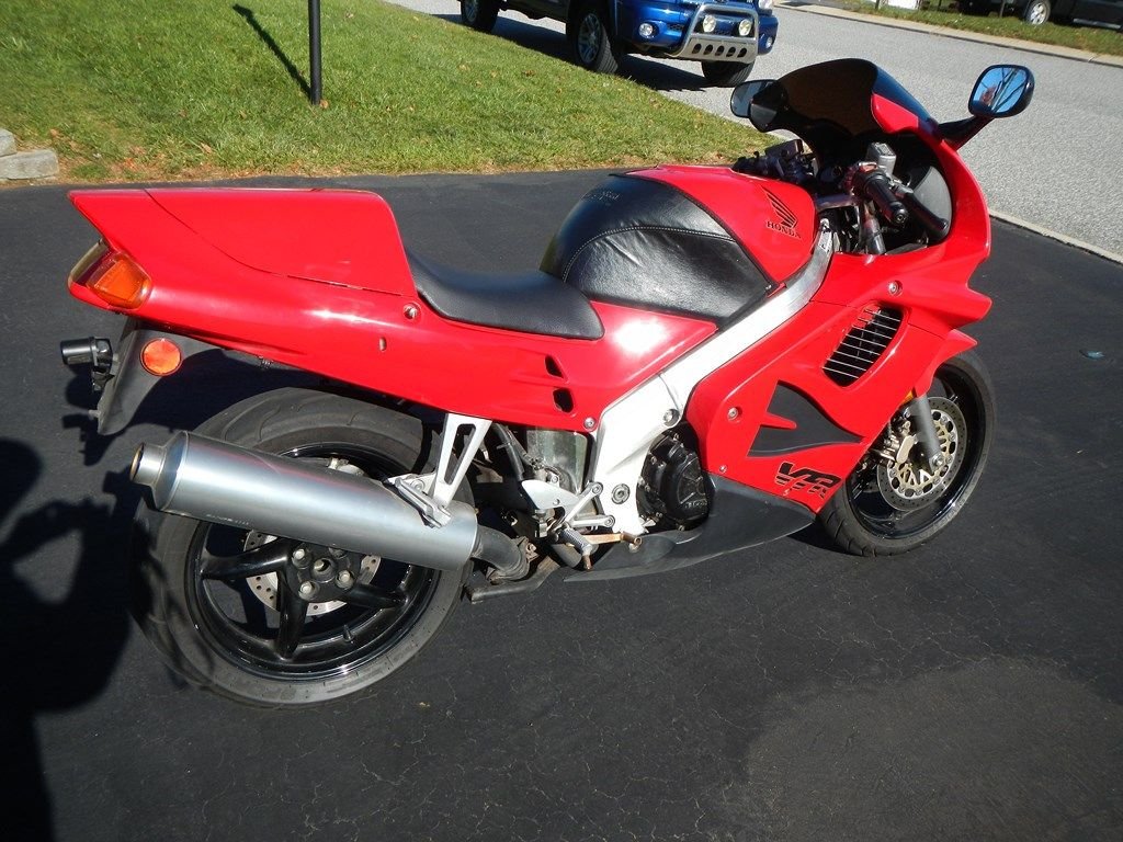

Below are a few that I have had over the last 15 years or so.
Son with the Ninja he did most of the work on.
