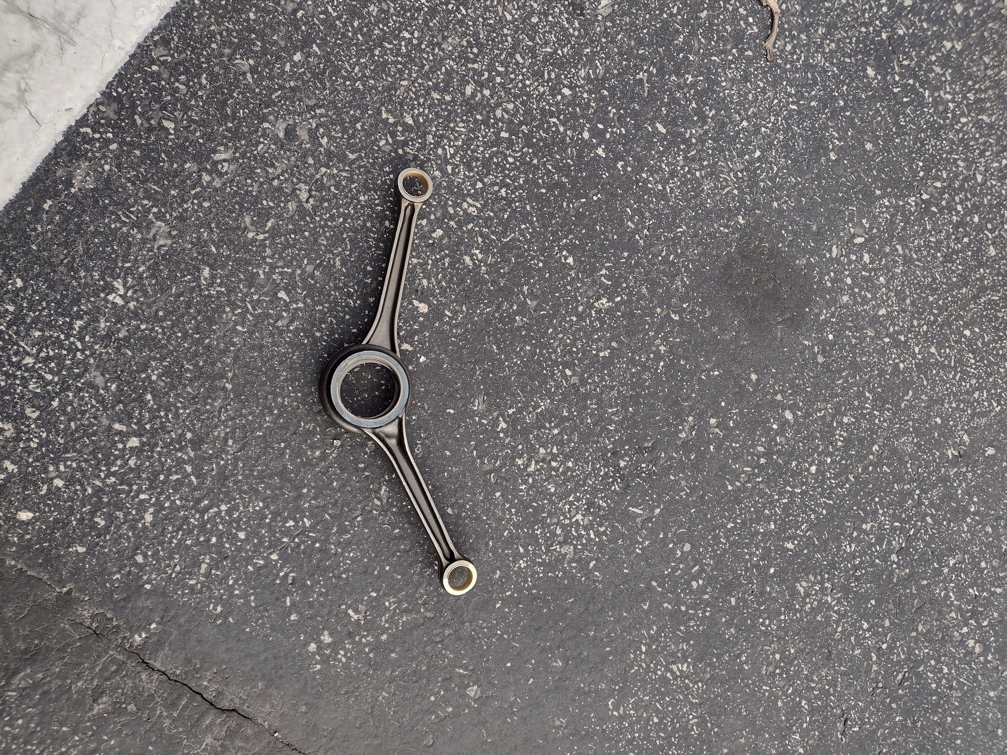

Some of you have been asking for a pic of my rod.
Nice try but I'm pretty sure if you actually did it would look more like this!!
No we were asking for pics of your build, you know motorcycle torn down, engine on engine stand or bench or floor, cylinders being torn down. Just a stinking rod on asphalt tells us nothing.
Maybe you can provide a few pictures of your crankcase and new rods when you get it back from Dark Horse along with pictures of the assembly of the pistons to the new rods, cylinders and new pistons. But I expect that will not happen.
You right, I am not going to. It is not like it would make you happy. I have put up pictures in the past.
On other forums I did write ups with pics. But now adays you you can find that on you tube. People like to show a pic of their bike on the rack, which really doesn't provide any help. But I get it we like to look at pics. We tend to stop, and look.
But there is no point in providing pics. Plus where do you think I got the rods from? If you want to believe I don't own a bike, I am perfectly fine with that. Nothing will change your mind, and you are not the kind of person I am going to be buddies with anyways.
Either way, going to put the old piston and wrist pins in, and pin, and hang on the wall.
If you have the rods, you should have the pin, take a close up of the pin and the big end rod bearing surfaces, lets see why the rods where stiff.
Wouldn't that contribute to help and learning?
I'll look. Bad bearings is what caused it. To diagnois that lift up the rod, it should fall easy. Its kind judgement call. I am not sure I would caught, my friend pointed it out, and then compared on another open engine. Not like they are extremely restrictive. Hold it up, it should fall right away, not stand up for a second. Again something someone experiend pointed out to me.
