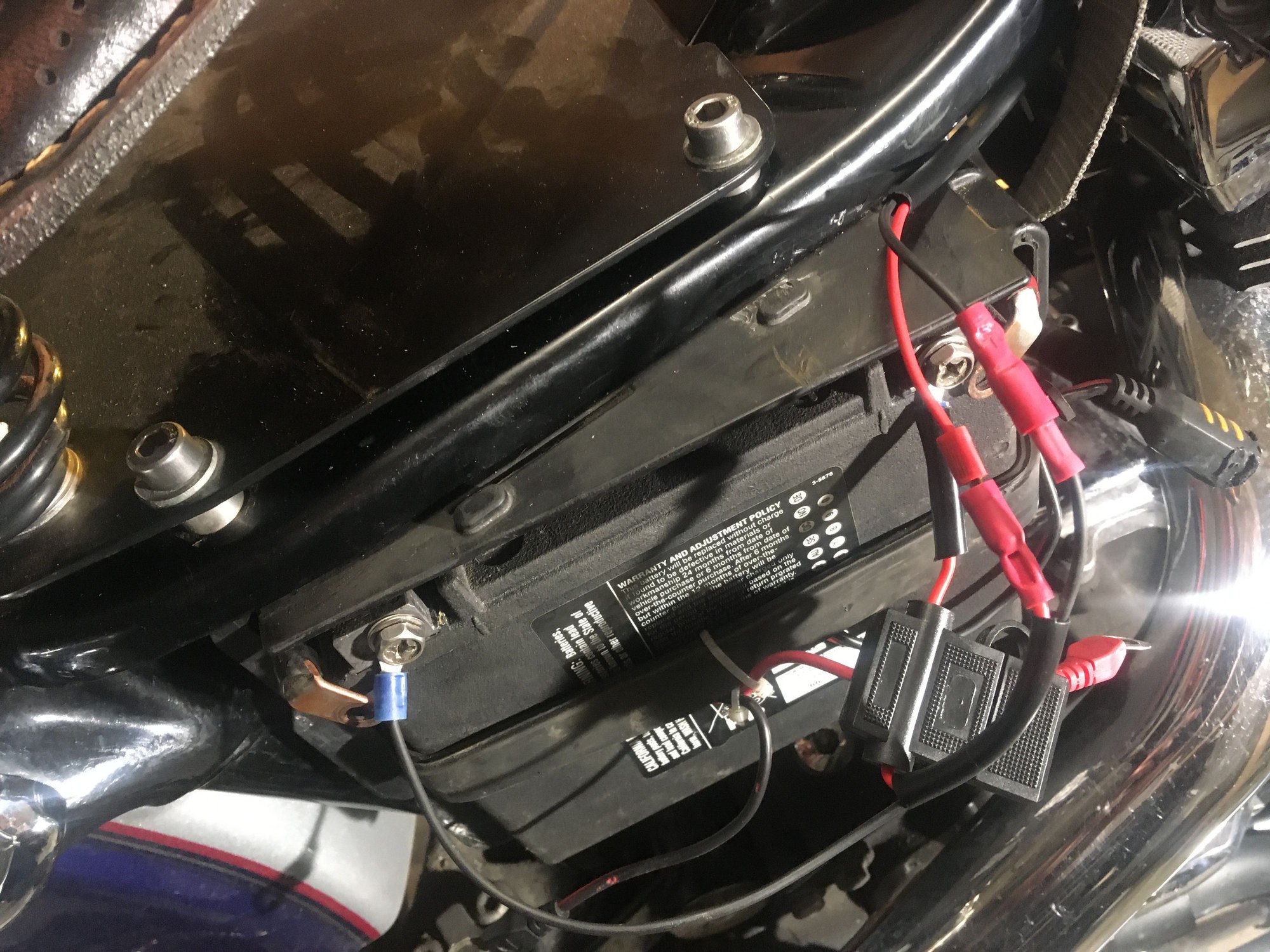

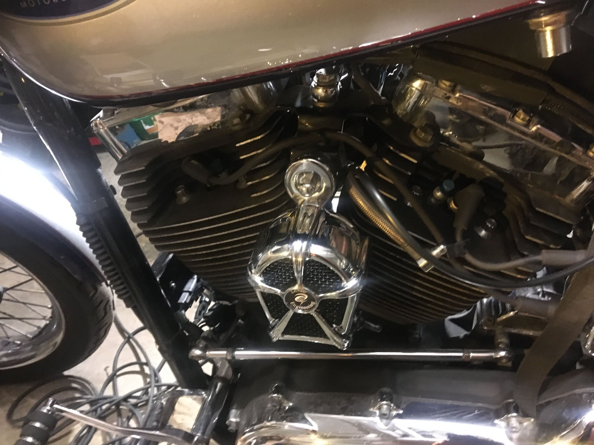

The LeNale fan does not work. It is completely dead. I sent it back to the Ebay-seller today.
I removed the horn and screwed the LeNale on place. Then without routing the wires, I connected the fan to the battery, just to test it. No life in that fan. It came with a fuse unit. After that there was 13.05 volts. So fuse was ok. The switch on the fan is covered with silicone, so I could not take any readings there.
The LeNale on its place.
Connected to the battery with its fuse unit.

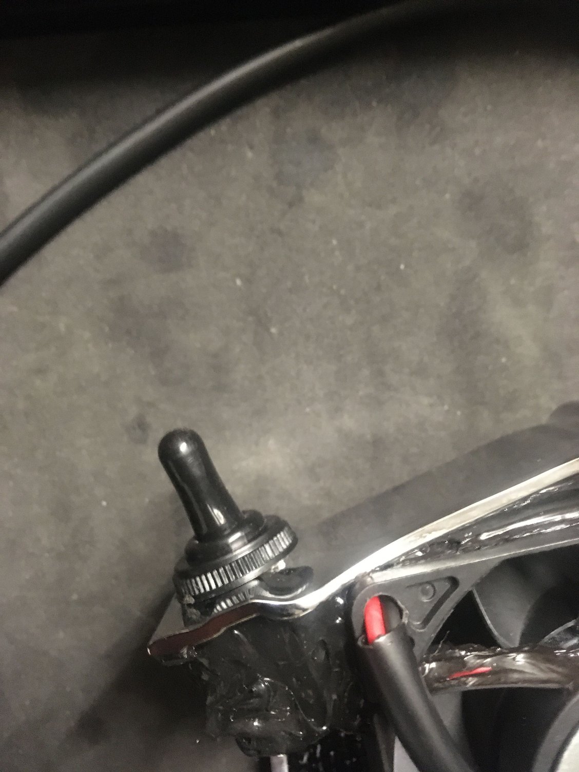

Switch does not attach properly to the shape of the fan cover.
Lots of silicone, but not under that round black switch nut, holding it to the chrome cover. The switch may be exposed to water there, I think. Hard to tell off course, but it does not look good. The switch should be screwed to a flat surface.
I removed the horn and screwed the LeNale on place. Then without routing the wires, I connected the fan to the battery, just to test it. No life in that fan. It came with a fuse unit. After that there was 13.05 volts. So fuse was ok. The switch of the fan is covered with silicone, so I could not take any readings there.
Greetings from Sweden, that thing does not look very well made, and if its not even working I think you should return it and have your money refunded. I also think that tiny fan blowing air between the cylinders will have very limited impact on the engine temperature. A fan assisted oil cooler is a much better option.
That crimp looks sketchy on the ground connector.
I was out riding Sunday and was slow rolling around the LSU campus for quite a while when I remembered I had the fan installed, looked at the PV and the ET was 286° so I turned it on, wasn't even 5 minutes when we parked and the temp was down to 270°, very short test, but the temp dropped, The next time before I take the bike out, I'll do a static test comparing cylinder temps with a infrared temp gun.
The plus-connector actually fell off upon trying to connect it, so I had to replace it. The ground one I did not touch, as it did not come off and it seemed to have sufficient contact. But it is not well crimped, as you say.
