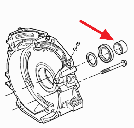

I rebuilt my 09 t/c got everything back together, but the engine won't turn over. Opened up the primary and removed the chain and tensioner. The issue is the drive sprocket won't rotate. I can put up to the torque limit of 140 ft lbs on the bolt and the engine still will not rotate. It was rotating, when I assembled the engine, install pushrods, rocker plates and you have to find TDC.
​​​​​​It did sit for about three months after being rebuilt. I have fiberoptic camera and inspected the jugs through the spark plug openings and everything looks bright and clean.
Any ideas as to the issue and corrective measures?

Originally Posted by Ohio HD
Did you remember to put the sprocket shaft spacer back in?
And here is the winner! I somehow failed to put the washer in...
