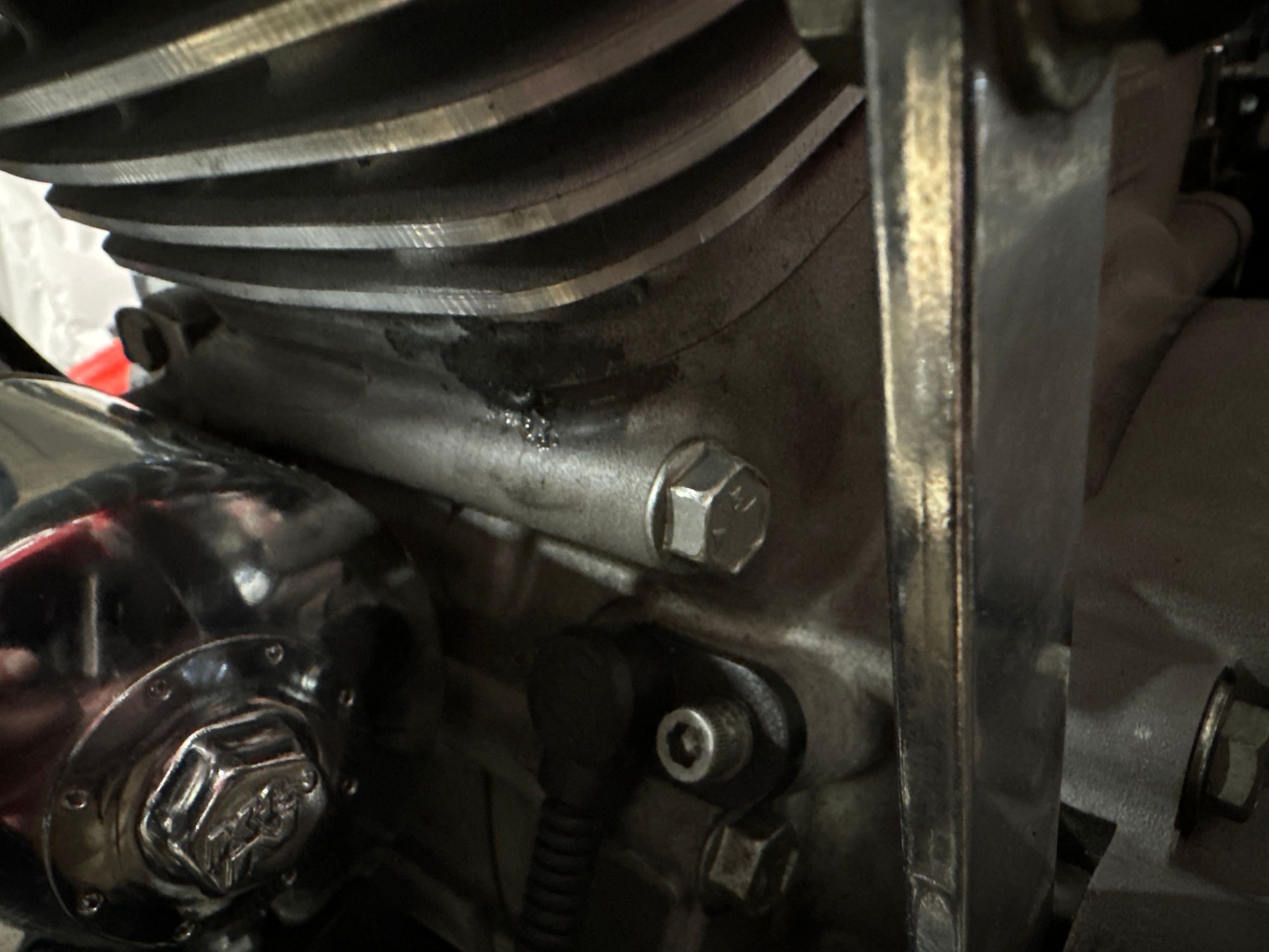

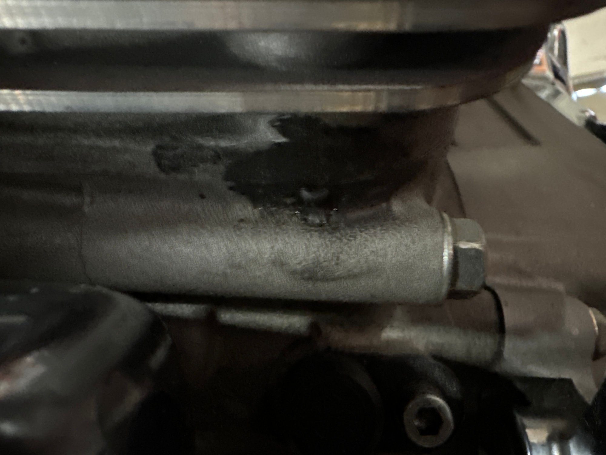

Can someone tell me if I managed to pinch an Oring on reassembly. Just did 100” S&S kit and I have oil seepage on front cylinder at the case. Looks like there is an oring petruding out now too.

Yep, that's what it looks like.
Take it apart and reassemble. New gaskets and o-rings. Don't worry about piston rings, hone. Leave rings on piston. Just try not to rotate them too much on reassembly. They will seat back in.

You would hone it first? No experience myself putting pistons back in after running.
Sure looks like an oring, but weird how the base could be pinched like that. I don't think oil return oring could pull out that far.

I've put pistons back in without honning. Because of base gasket leakage. As long as it's lower mileage. No issues. Never seen an o-ring extruded out before like that but stuff can happen. Probably happened on initial assembly.

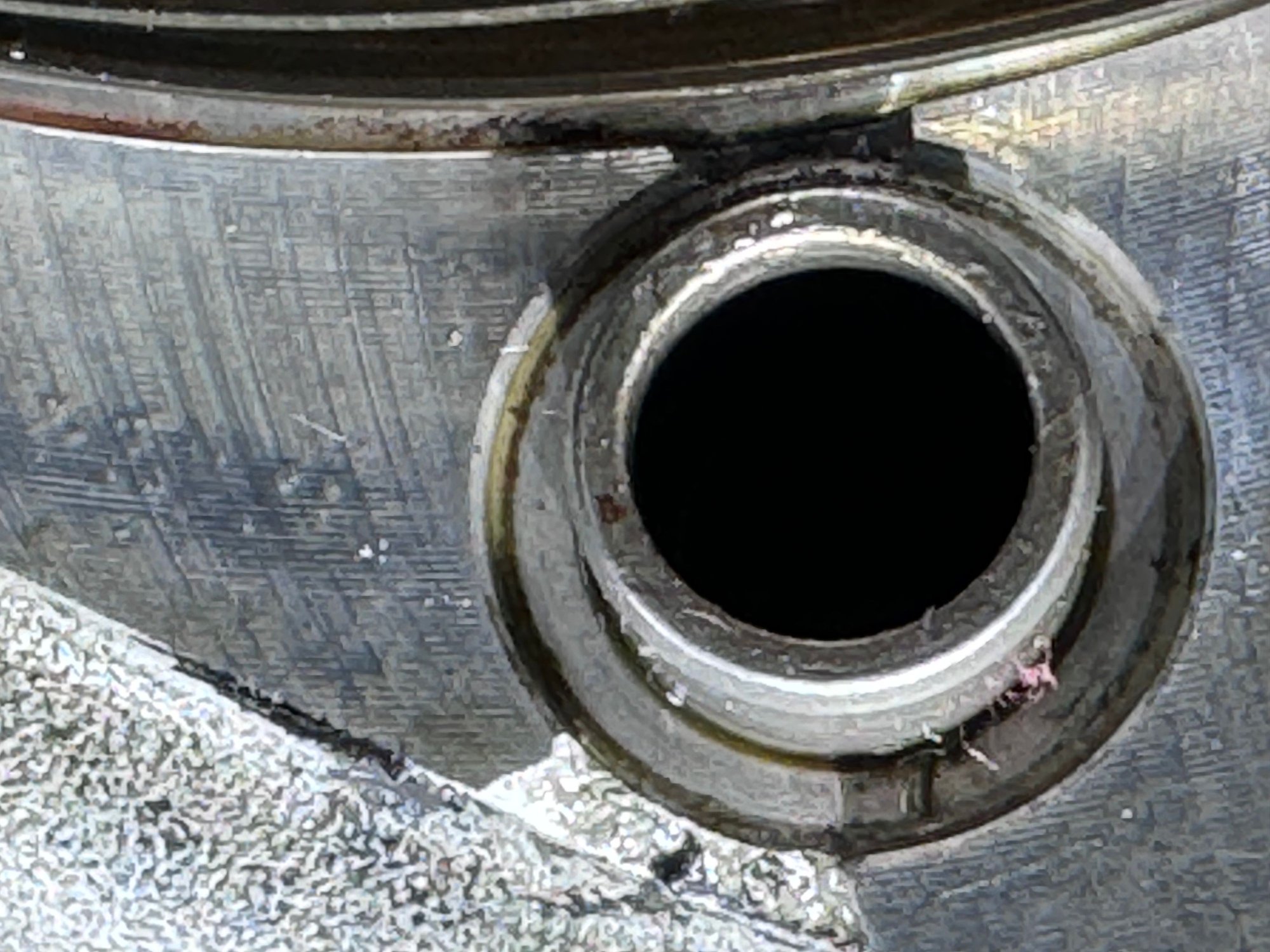

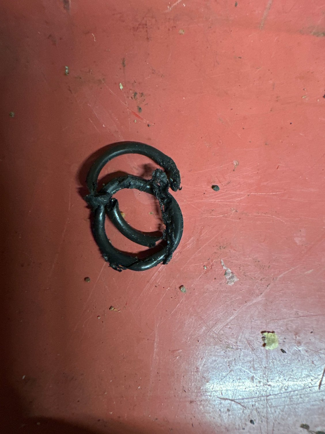

Well FML. So I took off the front cylinder and the reason the o’ring is sticking out the side of the case is it looks like there were 2 put on the dowel ring. They were melted together and that rubber had to go somewhere. I put the S&S kit together from new and I know I didn’t put 2 o’rings on it. I took the bike in to have some head work done with a tune. I’m assuming they put an extra o’ring on it. Now I have a channel out of the recess on both sides. Now what do I do?

They wouldn't of had to pull the jug if they were just doing headwork

Are those S&S dowels that have o-ring grooves or are they stock harley? Try the S&S ones if those are stock harley. Double check length of S&S dowel make sure it's not too long.
in any case, I'd put it back together surgically clean in that area with a bit of oil resistant silicone at that blow out spot.
