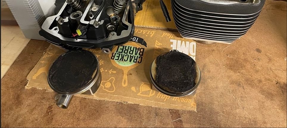

I tore the engine down on my `19 Electra glide at 15K, the coating on the pistons was so thick the valve pockets were not visible.

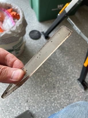

I cleaned the carbon off the pistons with a homemade scraper made from plexiglass.
After seeing how much crap was on the pistons I bypassed the breather to vent overboard.
The scraper is beveled at the square end also.

I haven`t so much as pulled a spark plug since the engine was reassembled (about 10,000 miles ago), but before the bypass the intake area always had a pretty noticeable amount of oil, now that area is clean.
If the big brown truck ever brings me a borescope I will take a look.

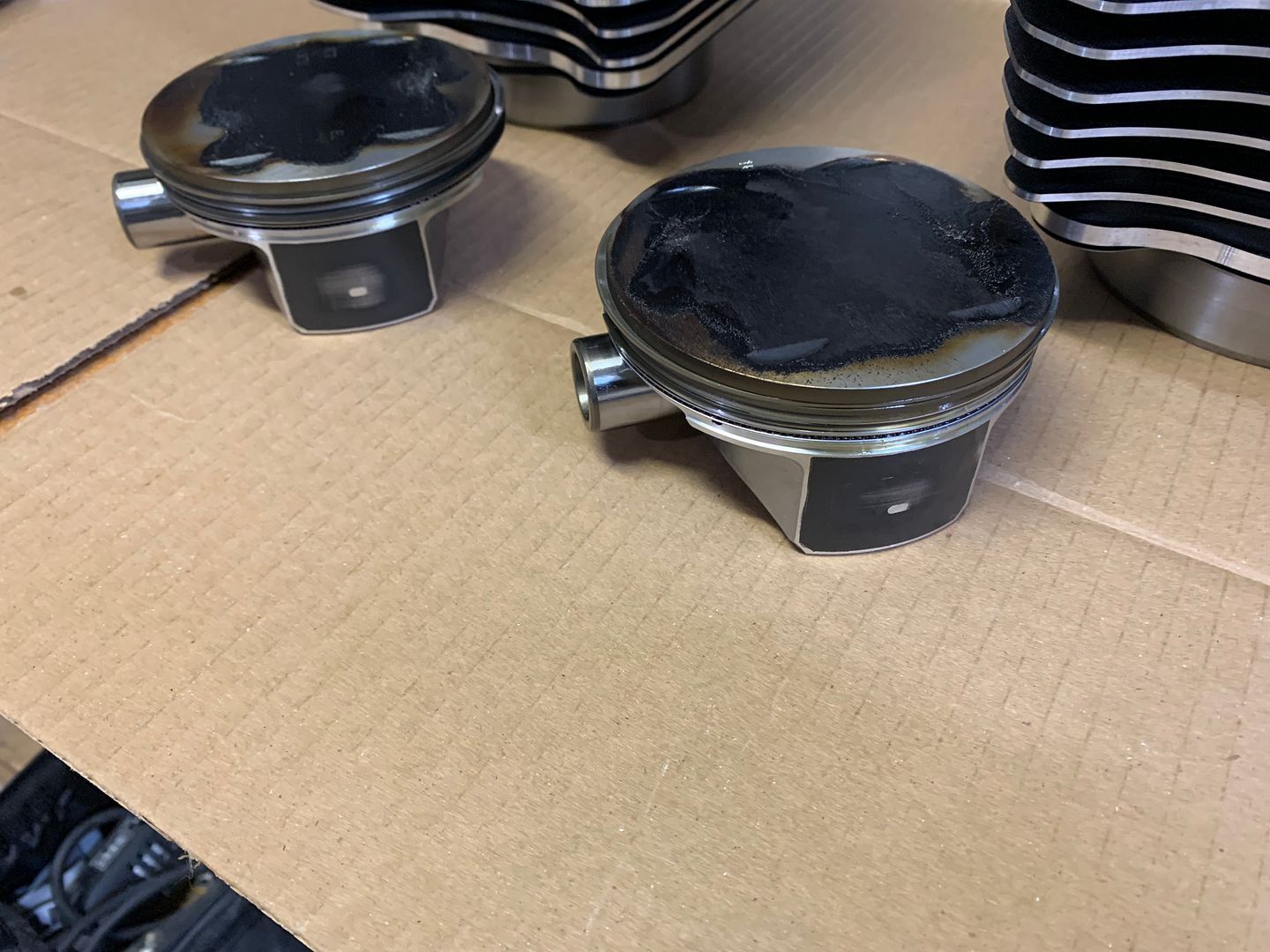

Here are the pics of my 1200 mile 114 pistons at teardown for the 128 kit.
I was initially appalled, I was not sure if it was the breathers, or the tune.
To be fair, the "tune" was a crappy SE canned tune for a 117 CVO that the dealer programmed for the aftermarket cam, exhaust, and intake with 1 mile on the odo. I fell for it, thinking I would be happy.
