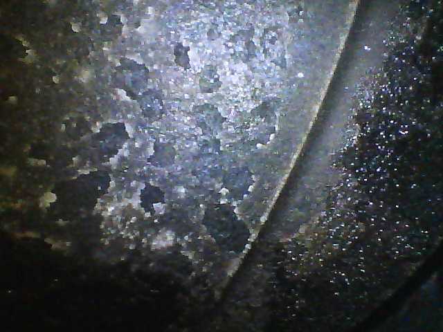

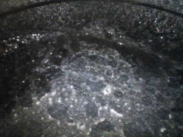

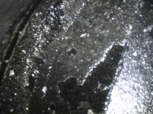

So, I really kick myself in the *** for not doing the breather bypass on my 14 SGS last spring when I did a full top end rebuild and everything was clean and shiny. The issue was that it's an Arlen Ness Monster Sucker and there was no quick/easy kit to install like the Drag Specialties bypass on my 03 RK. It required me to drill/tap/modify the intake a bit. Well, after 31,000 miles on it this last year, I recently got around to doing it after using my buddy's old Borescope and seeing what all that oil did to my pistons and such. (See pics below) After putting about 600 miles on the bike after the breather mod, everything in the intake and TB looks clean and dry, but now I want to see if I can clean those piston tops off. Or will they just burn themselves clean after a while. I still got my buddy's Borescope so I can monitor it for a before & after looky-loo. Didn't know if just using some Seafoam Spray into the intake would get down in there well enough to do any good, or I've also heard of spraying a mist of plain H2O in there as well. What would you guys do? Seafoam? Water? Something else? Nothing?

Just run it, time and heat will burn it off. Just make sure you are doing long runs like a couple of hours to get the engine up to good stead temps.
The piston tops will get some carbon on them anyway from the fuel and or un-burnt fuel that sits there after shutdown.

Just run it. There will be some carbon build up even with a breather bypass.

It looks fine to me. I had my engine apart during the cam bearing incident last year. I thought the pistons had build-up from the original owner putting 5000 miles on them with the stock breather system.
I'd already vented the breathers to ground so I cleaned the pistons up really good. They looked shiny and new. I ran a bore scope down the spark plug holes about 8000 miles later and they looked like they did before I cleaned them. Very similar to yours.

The breather valves were replaced with new ones at the same time as all of the other top end parts of course. The oil in my intake and TB has been accumulating since right after the rebuild. The last pic is AFTER I modified the breathers and put 600 miles on it......
