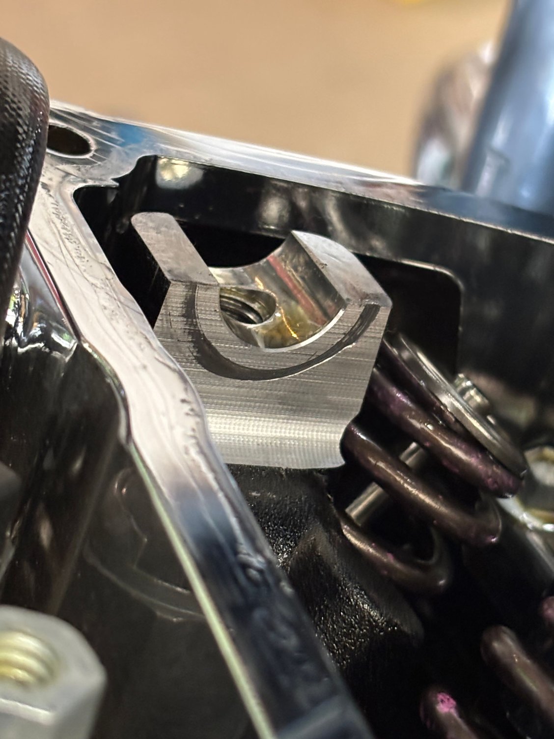

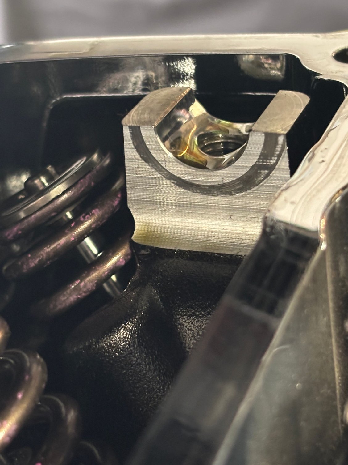

Some of it may be rocker related, sounds a bit excessive to be that though. I shimmed mine,
but even after shimming to .003” I still have a very pronounced ticking. It’s to the point that I can’t enjoy riding it because all I hear is that dang tick!
