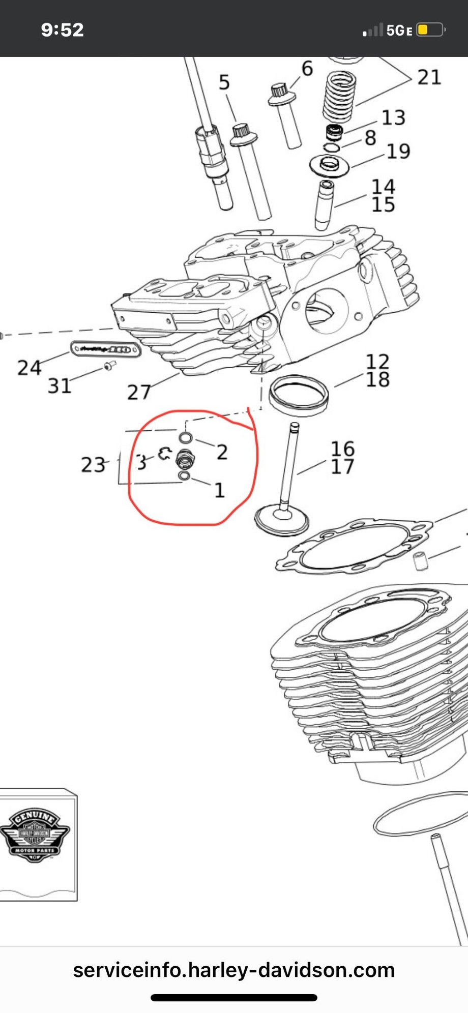

What is this item used for? One side has a bolt in it the other does not on front cylinder.
What is this item used for? One cylinder (rear)has a bolt in it the other cylinder does not (front) it looks like a blind hole with threads? Have I lost something?

My guess is it's the head temperature sensor. It is located on the front cylinder.

Some parts books show a plug for the threaded blind hole where the engine temp sensor goes on carbureted engines. I believe the actual sensor is shown on a different page but have no reference as to what book that picture is from. Either way it threads into the sensor blind hole.

That is for the twin cooled heads for anti freeze inlet hose

I totwas tally was looking at the head backwards! GREAT CATCH!

I disagree in the extent that we don't know what s&s super stock this is (evo, tc, m8, shovel). It depends on the application. Shovel, evo, tc would be an oil pressure guage outlet. **** m8. Too complicated for me.

Its a TC head.
