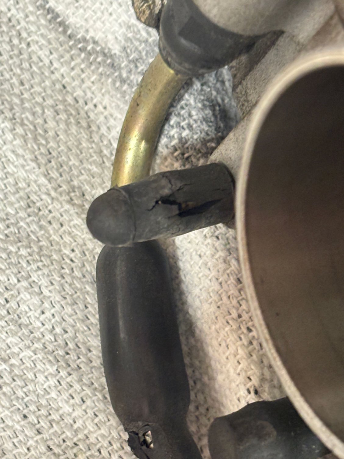

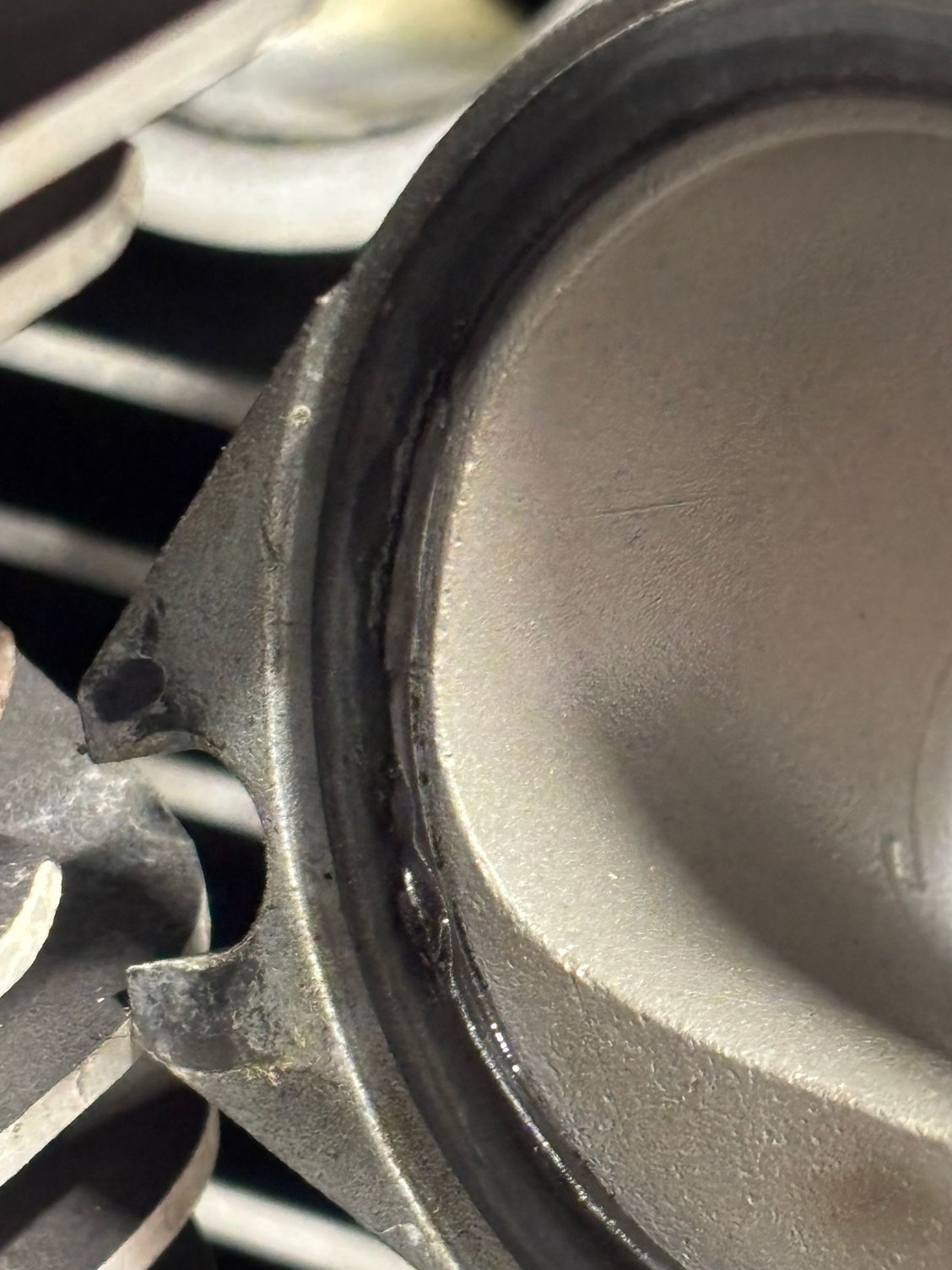

Originally Posted by garystaven88
The bolts are all 3/4" long so not sure what happened there. Again, I evenly and carefully tightened each one a bit at a time. I'm guessing those threads were already jacked up from another person who installed that intake years ago. It didn't feel good when I removed it.
I bought a 1" long bolt and it worked perfectly. Plenty of room before it hits the wall of the blind hole.
Runs much better without intake leaks!
Originally seal deterioration
Original seal deterioration
Vacuum plug on Mikuni deterioration
Based on the intake with it's flat lower part, it looks like you have HTCC heads. I'd bet that those with the TW50 cam and higher compression pistons would do well.
