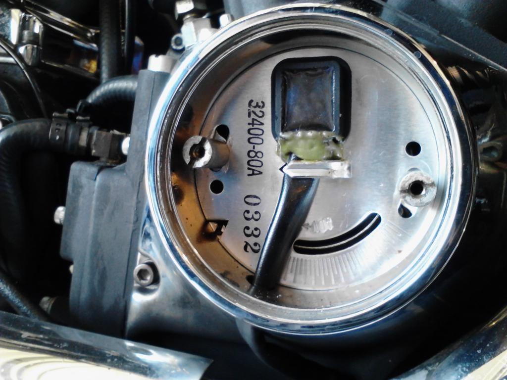

If you rotate the ignition cover plate 90 degrees, you can use screws to reattach it. Or just get the correct rivet, which is a blind rivet. That means that the end that goes in is solid, not open like "regular" pop rivets. You should be able to purchase a box of them for what a dealer will charge you for two.

Here's what it looked like under the nose cone:
I used two pop rivets to put the cover back on. I guess I should drill those and get some blind rivets. I was going to tap the holes but, I didn't have a tap that small. I will pull the outer fairing tomorrow. Tonight is football..

You don't need to tap the holes if you just rotate it 90. But then the plate won't read properly. I use a generic chrome plate, visible here:
Besides the Screaming Eagle module and extension cord, my ignition is stock.
