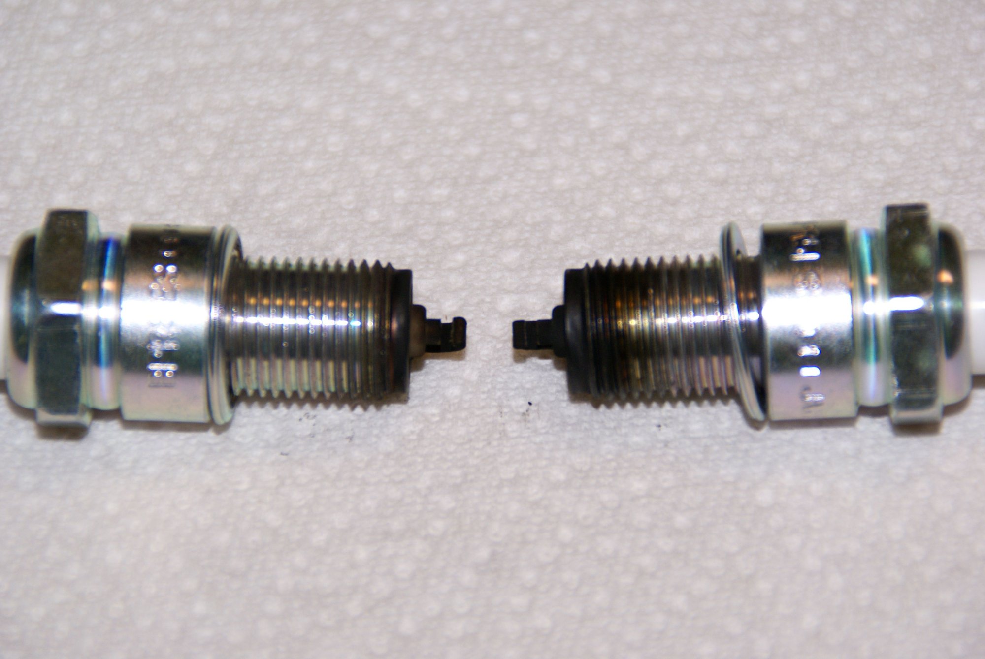

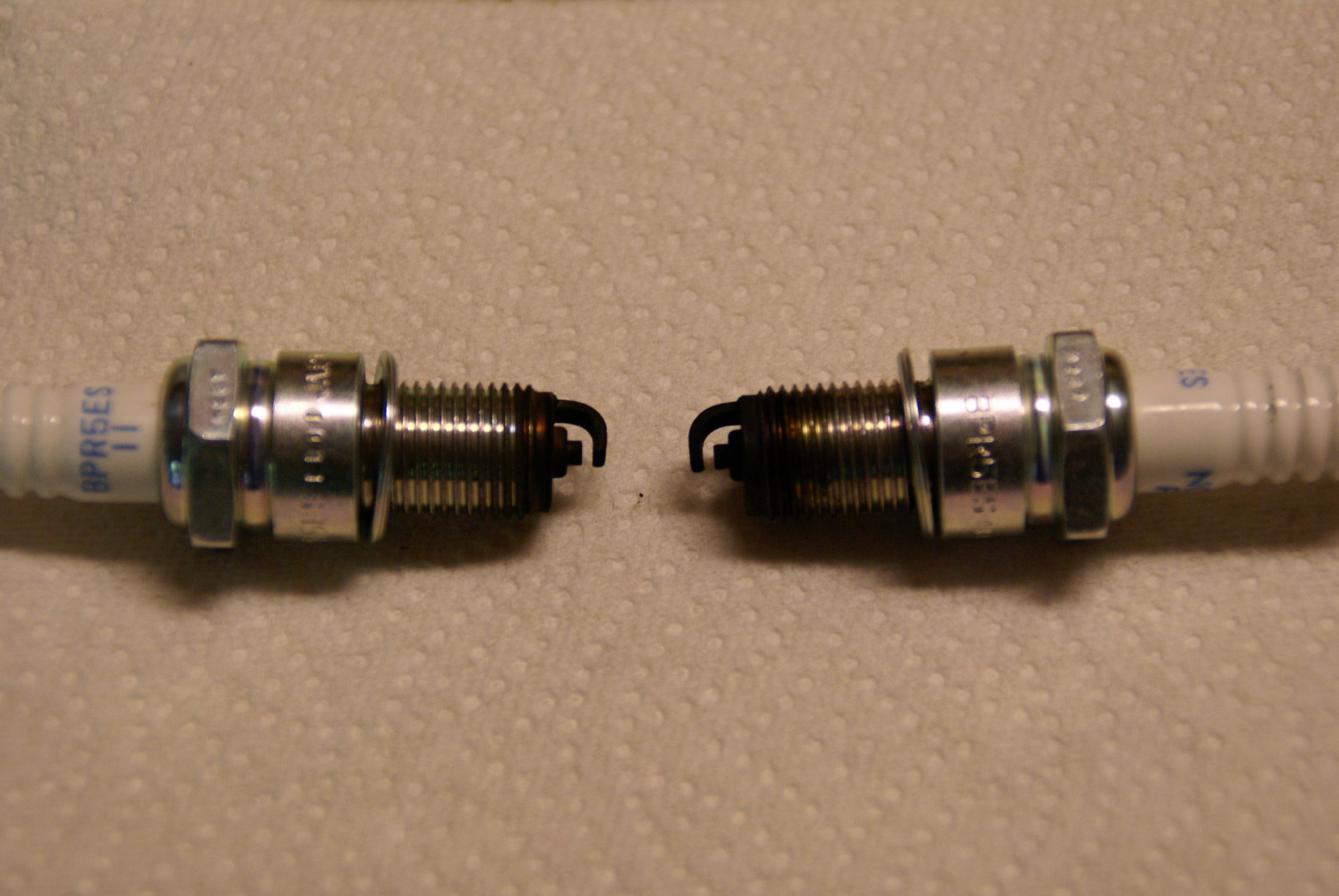

Actually by the video it sounds as if your getting it at higher rpm's as well. When you put the pipes on did you re-jet the carb? For now Pull the plugs and post a pic. It will tell a lot.. Just let us know which one was the rear....Thanx....
Here's a pic of the plugs. The left is the front, right is the rear. Also jets are 46/185 which were changed out when I went with the Ness Big Sucker last year. Definitely not too lean.
Thanks!
Tony

Pulled the rear pipe again this morning and replaced the gasket. I've included a pic of the old gasket. Also did not see any carbon around the o2 bungs or the pipe flanges.
I did try the dollar bill and it would get sucked in every couple seconds.
It will be the beginning of next week before I get a chance to pick up a compression tester. Will it hurt to ride it if it is a burnt valve?
Thanks!
Tony
