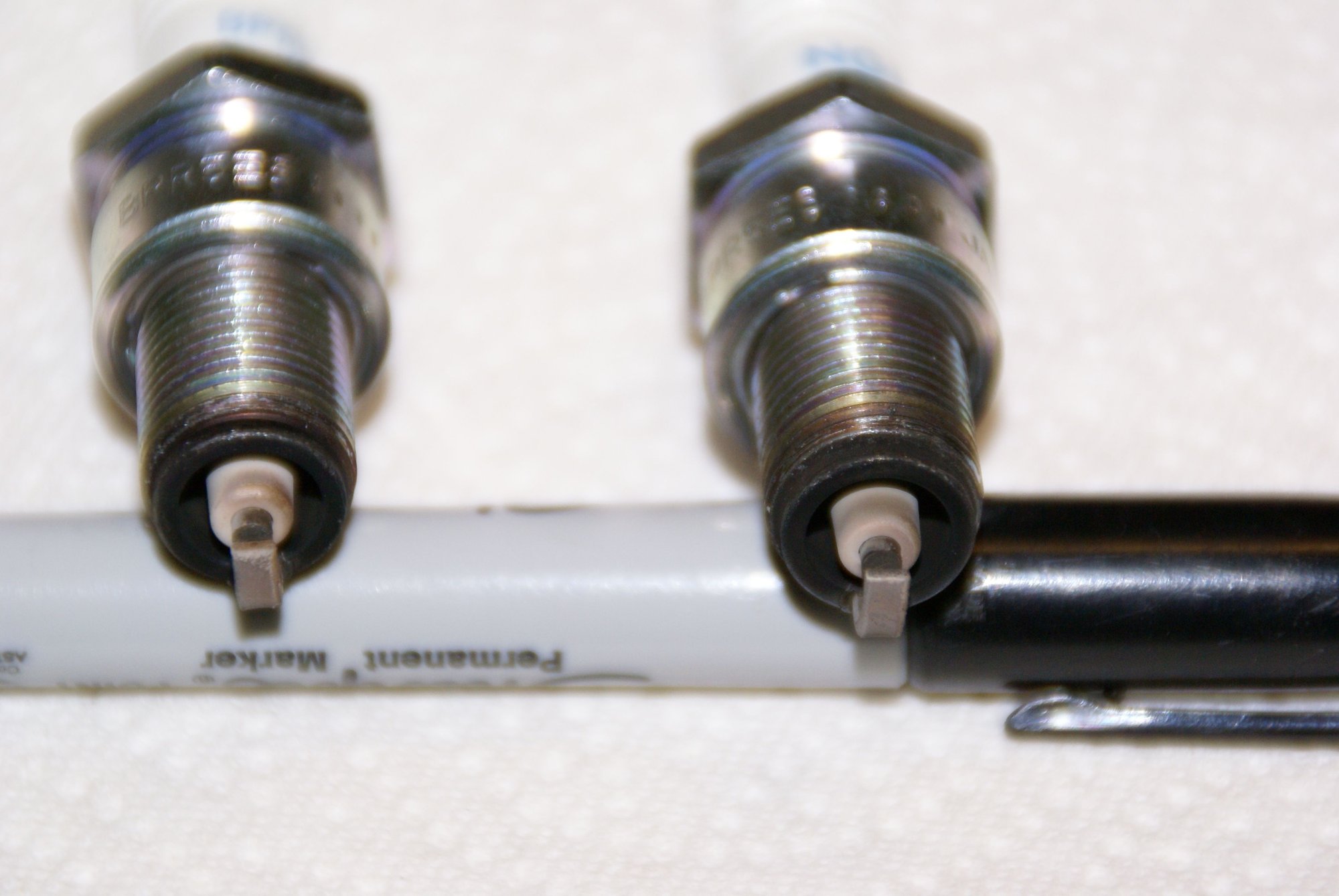

Got a chance to do the compression check today after warming it up.
Front 112
Rear 110
Pressure stayed steady for a couple minutes.
After doing the compression test, I did hook the air hose to each of the cylinders at a pressure of 60 psi. The front cylinder initially bled down fast and then slowed and then stopped at 30psi. The rear cylinder bled down fast and then slowed and stopped around 20 psi.
Listening to the engine running with a stethoscope there is a touch more noise in the rear cylinder at the exhaust side of the head, but not much more...definitely not what I'm hearing at the pipe.
Also, here's the plugs after a 170 mile ride through the Georgia mountains yesterday...a nice tan on the insulator and ground strap.
Thanks,
Tony

Hey Tony, Those plugs are super lean. Your compression seemed a lot low. Do you have compression releases or something and did you have the throttle plate wide open. when you pull the plugs pull the wires off also and make sure your battery is at full charge and crank it over at least 6 to 8 full revolutions after the engine has been warmed up a little. (not real hot, it's not good to mess with plugs in a hot motor with aluminum heads) your initial crank should get you to 130 psi even on a stock motor and 175-180 after crankin for 5 or 6 full revolutions. After that checks out then do your leak test on the valves but you need to make sure that the pistons are at top dead center on the compression stroke you can feel the piston coming up with a straw, or something a little flexible like that so you won't harm anything in the cylinder or the piston. once that is all the way up then slowly put air to the cylinder and listen. If a valve is leaking by you definitely will hear it and make sure you do both cylinders so you can hear the difference if one is bad.

Gotta disagree.... The plugs are about as dark as you want to see them with our gas these days. It just runs a bunch cleaner. Tan is the new rich. And 110, while low is within spec. Definitely do your compression test on a warm motor with the throttle open. And make sure the valves are closed for your leakdown.

Thanks 98hotrodfatboy and Owtlaw! I did it with it hot...after a ride. I'll check the leakdown in the am.
To the eye, the ground strap and insulator are actually tan...in the pics it looks lighter.
