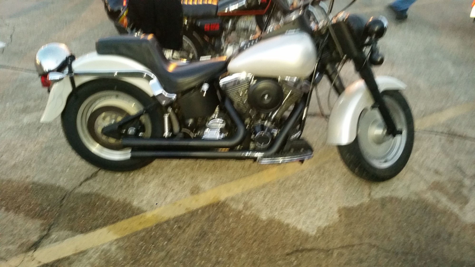

Well I have done it ... and I will be peeling it off... luckily i can do that. It's a great look so at least I know I can fork out the money and either sand the parts down my self and properly paint them or have the pieces sent off to paint. I sprayed quite a few things and every where it's sprayed has some kind of issue except for the light cssing. NOTED . and thanks for the input.
Old Jul 23, 2015 | 10:30 PM
Paulwall504's Avatar
Paulwall504
5th Gear
Joined: Jul 2015
Posts: 9
From: New orleans
This one shot i got the other night , sorry its fuzzy .but the look is great ....the paint sucks for a motorcycle! Anti plasti dip for motorcycles
