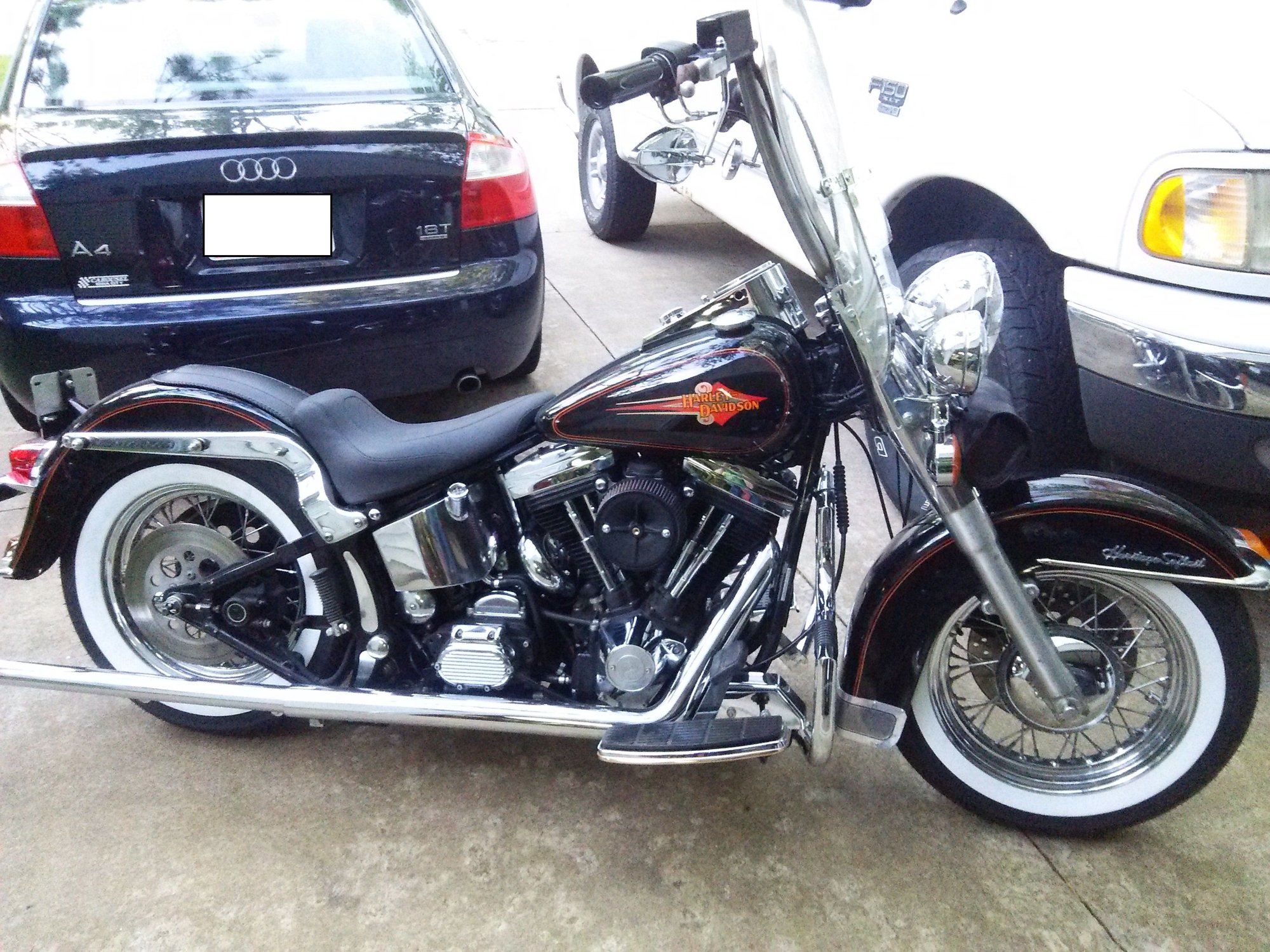

Happy Friday fellas. Finally getting into some good riding weather here in Iowa!
Here's the question of the day - I have had my 93 heritage out a few times this winter when it was warm enough to tolerate to cure my pms (parked motorcycle syndrome). I always warmed it up well like evos need before riding it. Anyway, I noticed a little oil around the rear cylinder base and a little bubbling (odd because it had all new engine gaskets last summer). then I noticed a little oil seepage around the front cylinder where the head meets the cylinder. So...I checked the head bolts and as suspected, they were loosening up. Has anyone else come across this, and would it be ok to just re-torque them in the same pattern as when assembling the engine? What are my options? All four on the spark plug side were somewhat loose - as in moderately easy to turn with a wrench (maybe 10ft lbs).
Thanks

Old Apr 15, 2016 | 09:24 AM

Originally Posted by Panheader
On a side note......what intake is that?

Love to know what that Air cleaner is too, nice low profile to it.
Steve
