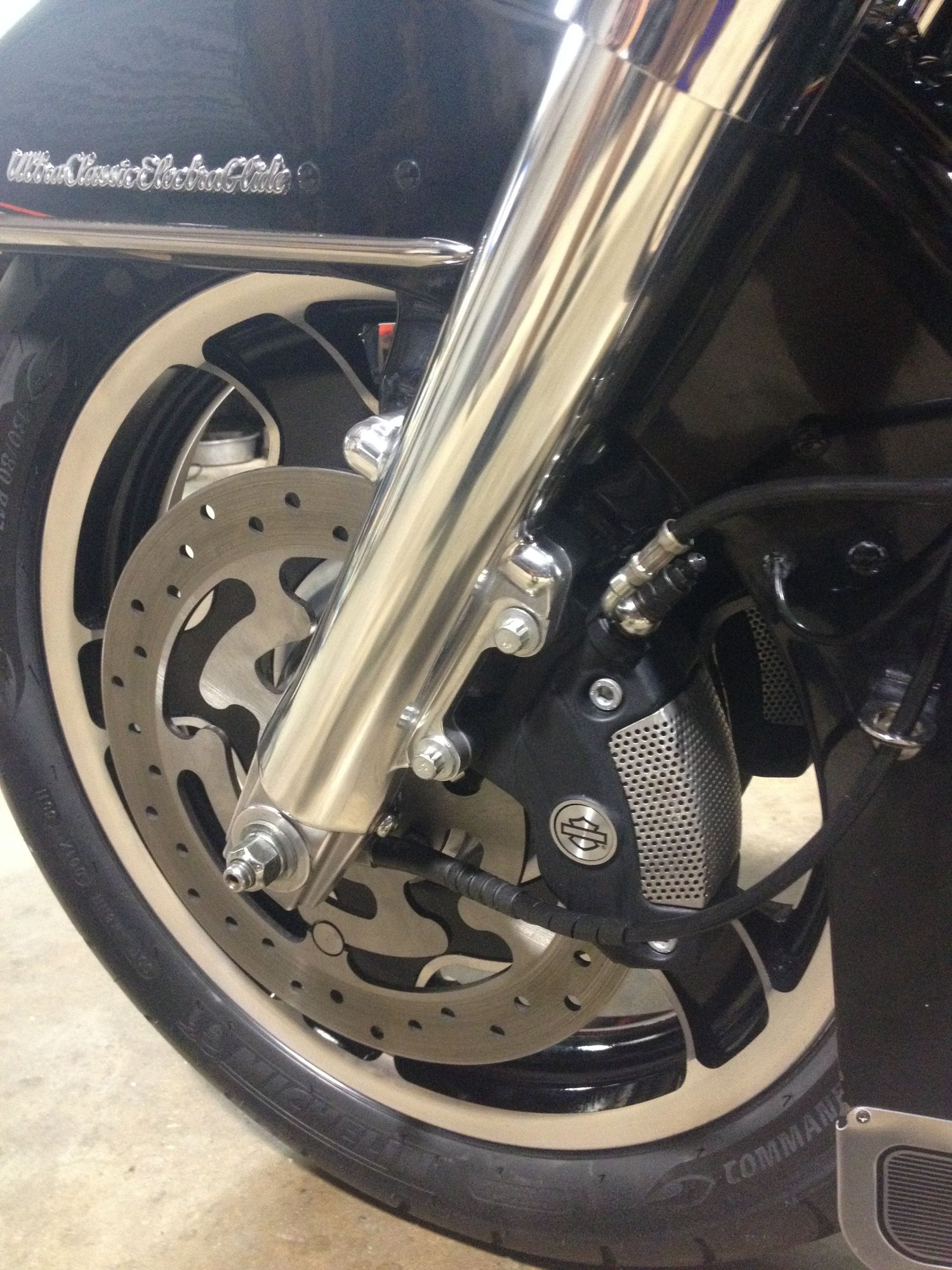

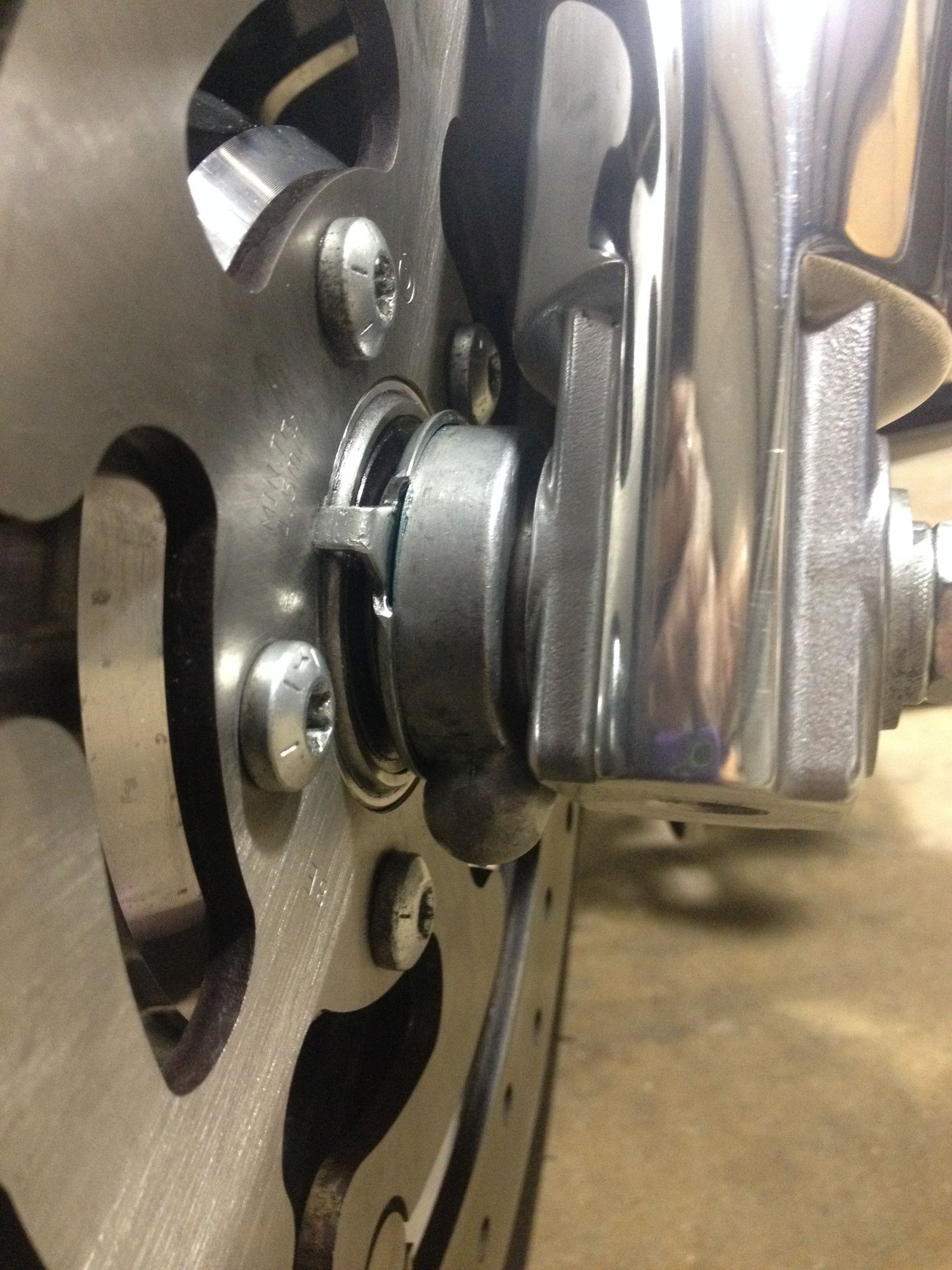

Be creative. I have a 19" Enforcer wheel on my '94. Here's how we managed the Speedo drive. You might be able to do something similar, use your imagination and you might find a way to make it work.

sweet!
