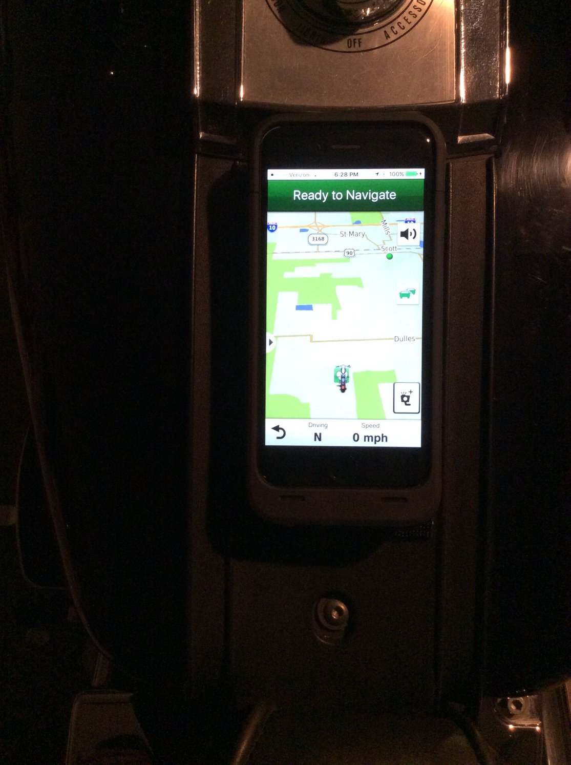

Arrange the strips on the tank bib / plastic portion of the dash on your tank for a trial fit. On mine, I went four wide and two high. Then simply peal the backing off and carefully attach them to the tank panel. Once you get the first one down, then it is just a matter of butting subsequent pieces down tightly when you apply them. The way my panel is made, there is a ridge on either side, so I used that for a guide and left about a one quarter inch gap on either side.

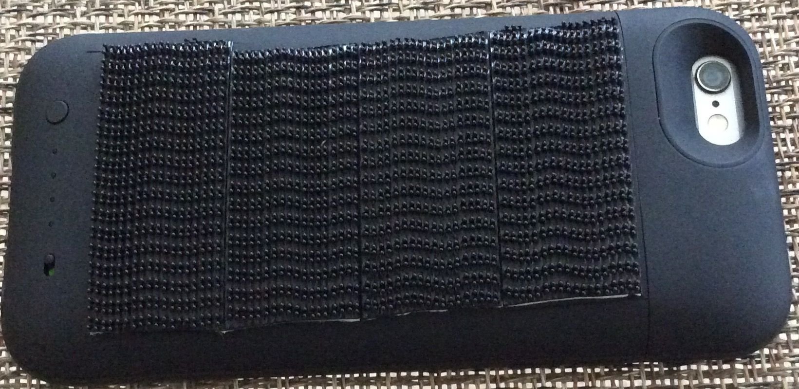

Next I applied four strips horizontally to the back of my phone case, pressing them very hard, especially on the edges. My phone case has a slight curvature to it which is no problem, but on the edges, it curves a lot to the front instead of being made square. I then took the razor knife and trimmed the sides off that did not go around the curve. If you don't do this, the edge will get hung up on stuff which will lead to the 3M dual lock pealing off.

Next set your phone in position on the dash that you applied the strips to, then press down. Press kind of hard, because it interlocks in a more secure manner than Velcro.
If you download Garmin's GPS App or similar app for your phone, the maps will be stored locally. If you do this, then the GPS will work even if you do not have cell phone signal. It will also stop you from using up your data plan. I have all of North America downloaded to my phone in the Garmin app. It even let me select a motorcycle as a vehicle.

No, I am talking on the phone or texting or anything like that. This gives me GPS functionality which not only helps me in unknown areas, but will also tell me where the nearest gas station, hospital, etc. are. Sometimes the nearest gas station is behind you instead of in front of you.
