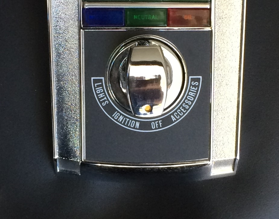

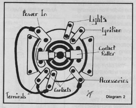

Show me your ignition, if it's like mine, you can disconnect the yellow jumper so the lights only work when you turn it to lights not in ignition.
Then once it starts, turn it to lights.
The jumper is yellow between the lights terminal and the ignition terminal. The picture is the ignition upside down, so everything is reversed. The jumper is accessed from the top.
