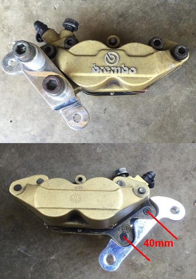

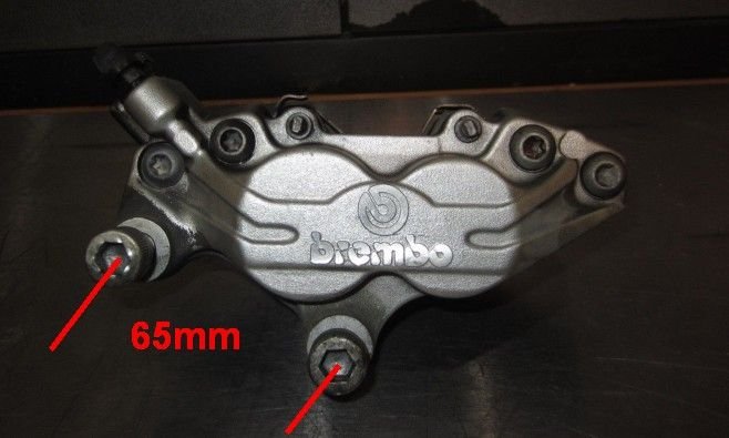

Yes that for a 40mm (mounting hole distance) Caliper. They are a bit less plentiful it seems compared to the 65mm.
Below is a 40mm cal mounted to that same adapter and then a 65mm cal
Any idea what models of bikes came with that 40mm caliper? Also any picture of it mounted on a bike? How is the stopping power of one of these compared to the stock single piston.
