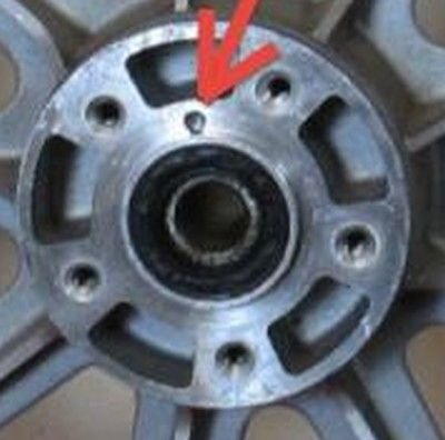

Originally Posted by grbrown
There's no slot in the hub, as the tang on the speedo drive is quite shallow. I have managed to bend one in the past, by being clumsy, so be kind to it!
You mean NO slot/hole like this one
