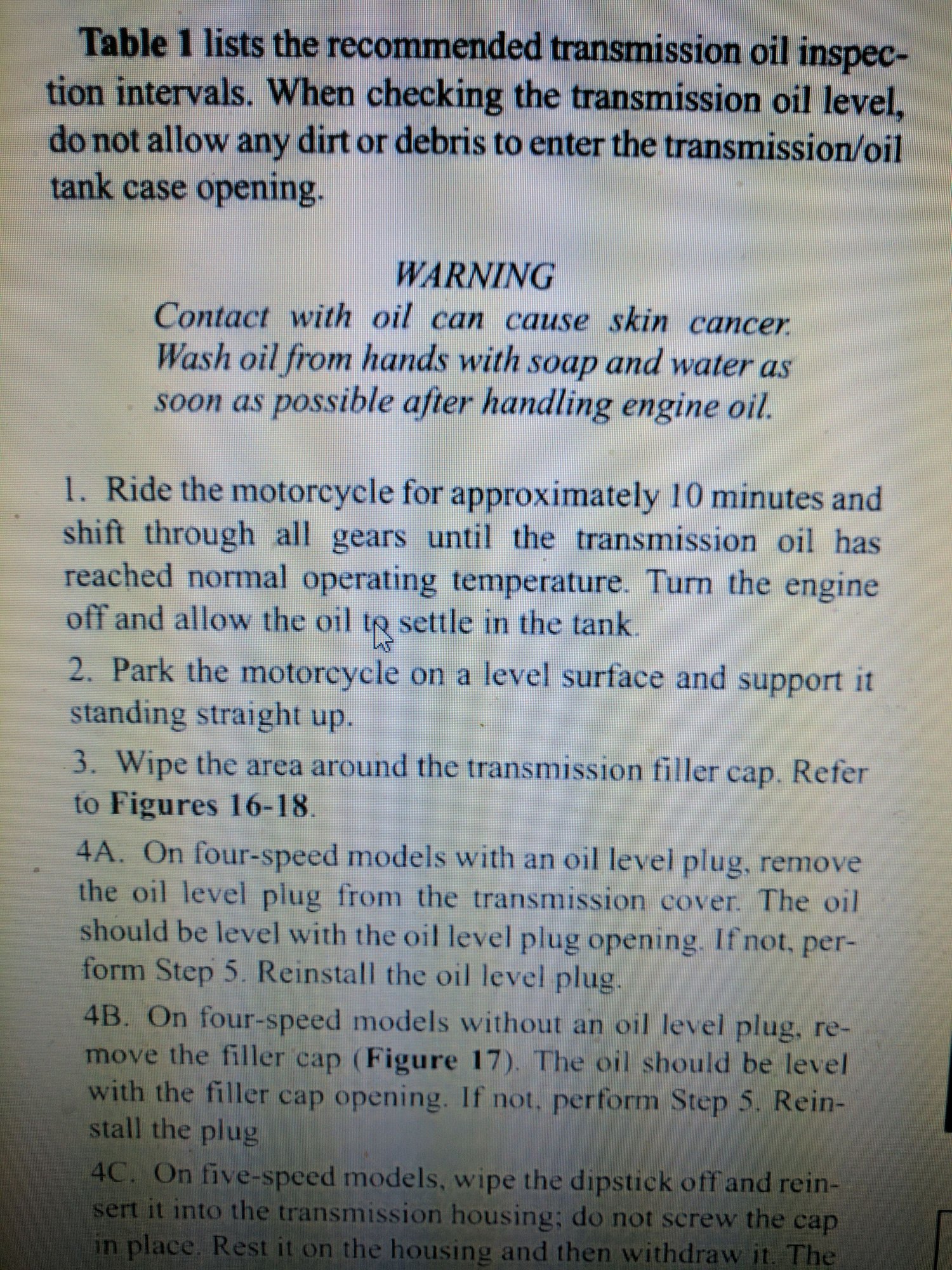

If you see the picture here, the manual calls for a ten minute warm up then to check while the bike is level. FYI Interesting to see different directions based on the year.

I gave fair warnings for older stuff and not antiques I guess?.... 10 minutes for a 4 speed to check the oil. That is $40 in shop fees at a local shop nowadays.
