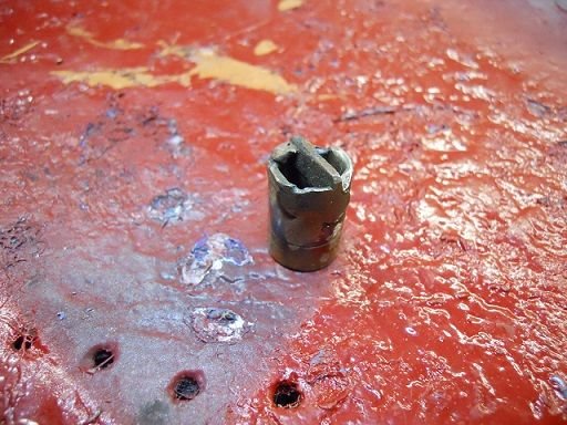

Originally Posted by Fblo1690
yea I guess I'm just being super paranoid. I had to dremel it because whoever did it before had it all marred up. And a big screwdriver kept slipping out.
Personally I'd be more concerned with the abrasive grit from whatever you were cutting with getting into the motor. Might want to change your oil a couple of times before you go tearing down the road.
.."a big screw driver" ? They make a removal tool for that cap. It's called a drag link socket. I'm cheap so I made mine.
