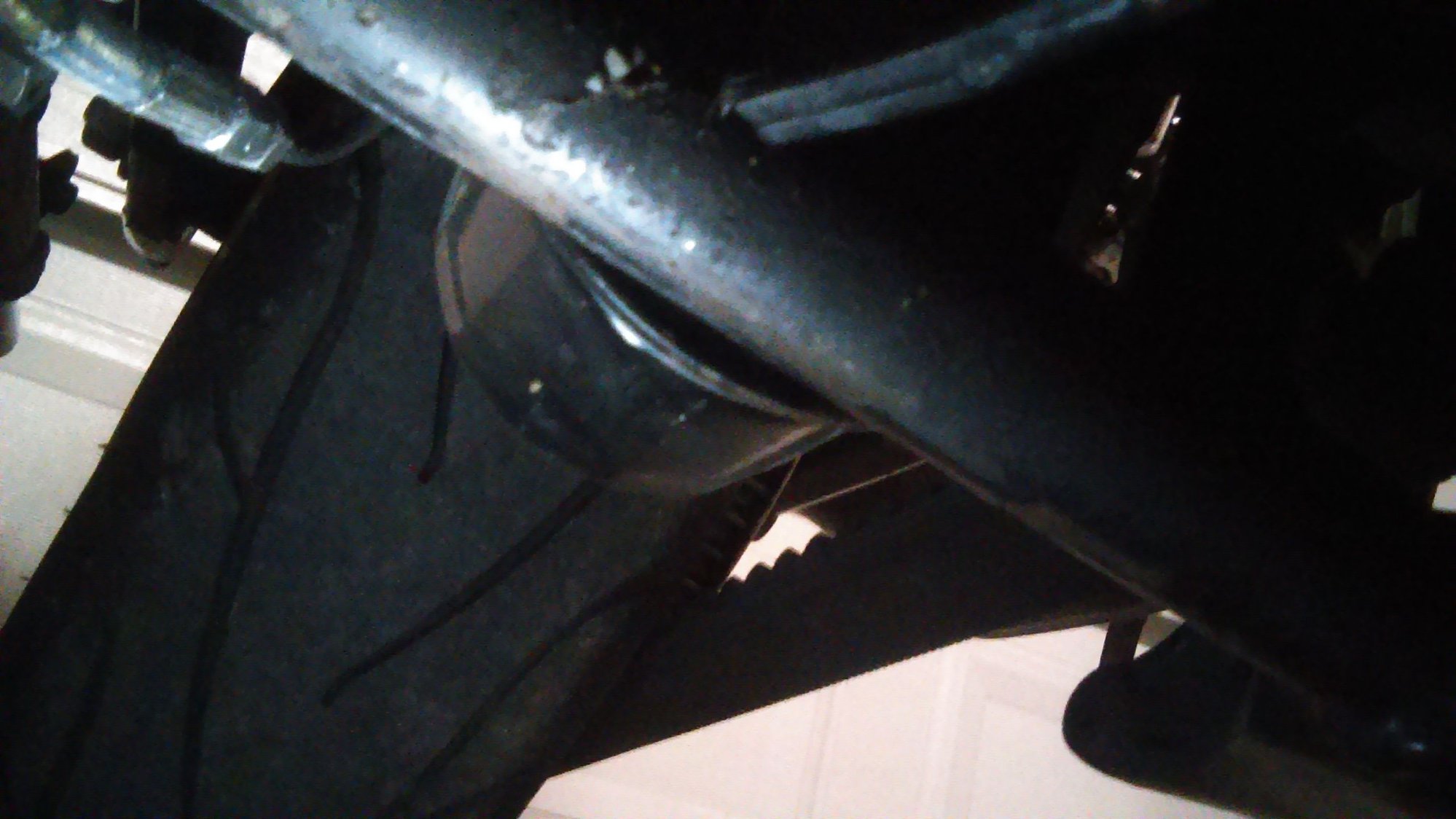

Originally Posted by glidein wide
Mine mounted oem near the rear wheel,love it there,convenient and mess free.
got a pic?

Originally Posted by Mattbastard
got a pic?
Sorry it's a little tuff...

Wow, that looks like a tight fit. My oil pan is in the way there, but thanks for the pic.

Plenty of room on mine,but it is a four speed.

Yea, you've got the oil bag under the seat too.
