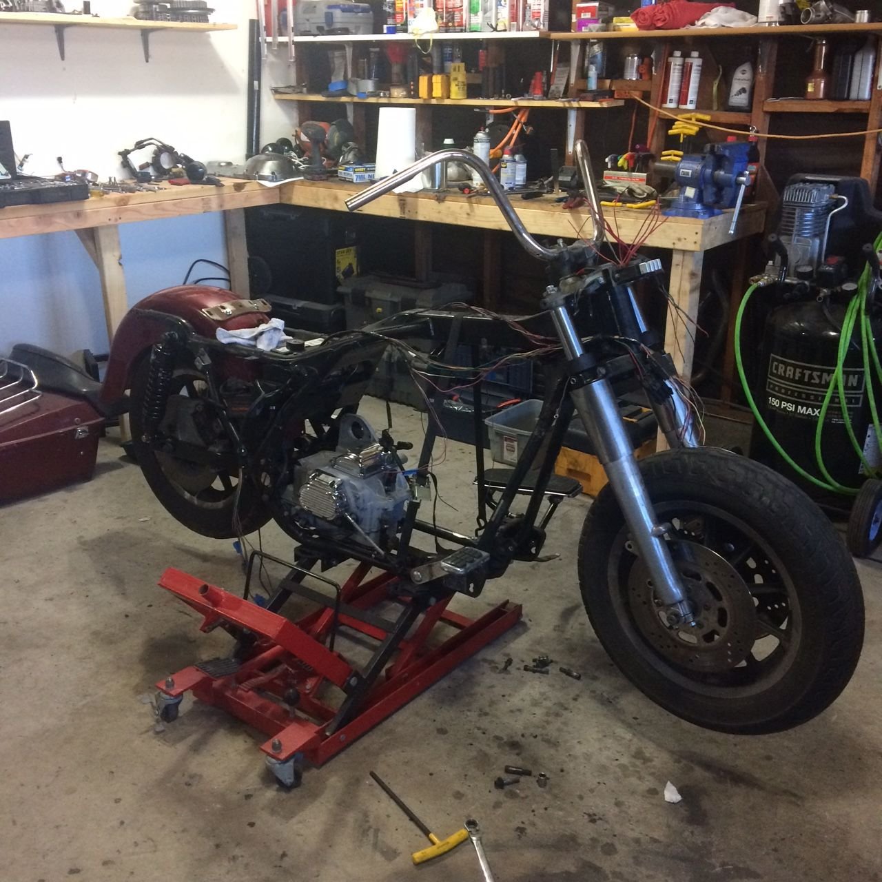

Didn't really paint the town red with bike stuff this weekend, I was feeling like chilling out more than getting greasy. That and I'm on a hold for parts. Starting to look like a bike again though:

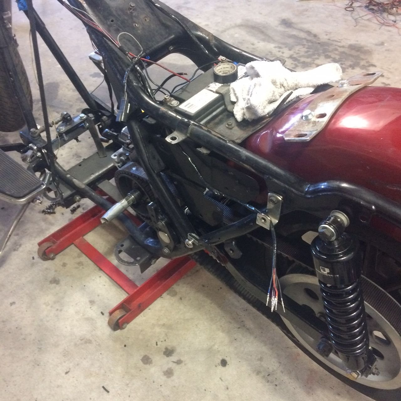

Cleaning up the wiring as well. You would not believe how much extra **** they have in this harness on account of using it on the Ultra as well. I ended up knocking the main harness down to 12 wires, the power, starter, and ground:

I'm figuring sometime after Thanksgiving is when I'll get it all back.
