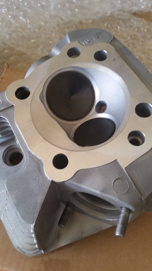

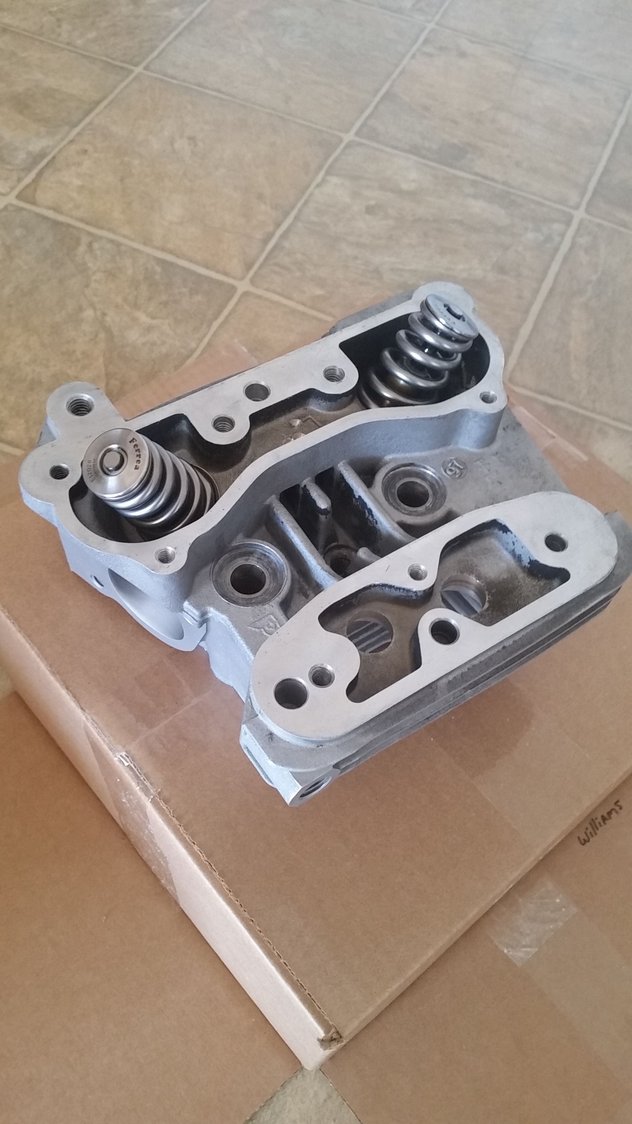

Great news! Got my engine parts back today.
30 degree angled squish band machined into heads. 1.98"/1.60" valves, 7mm stems with .600" lift beehive springs
