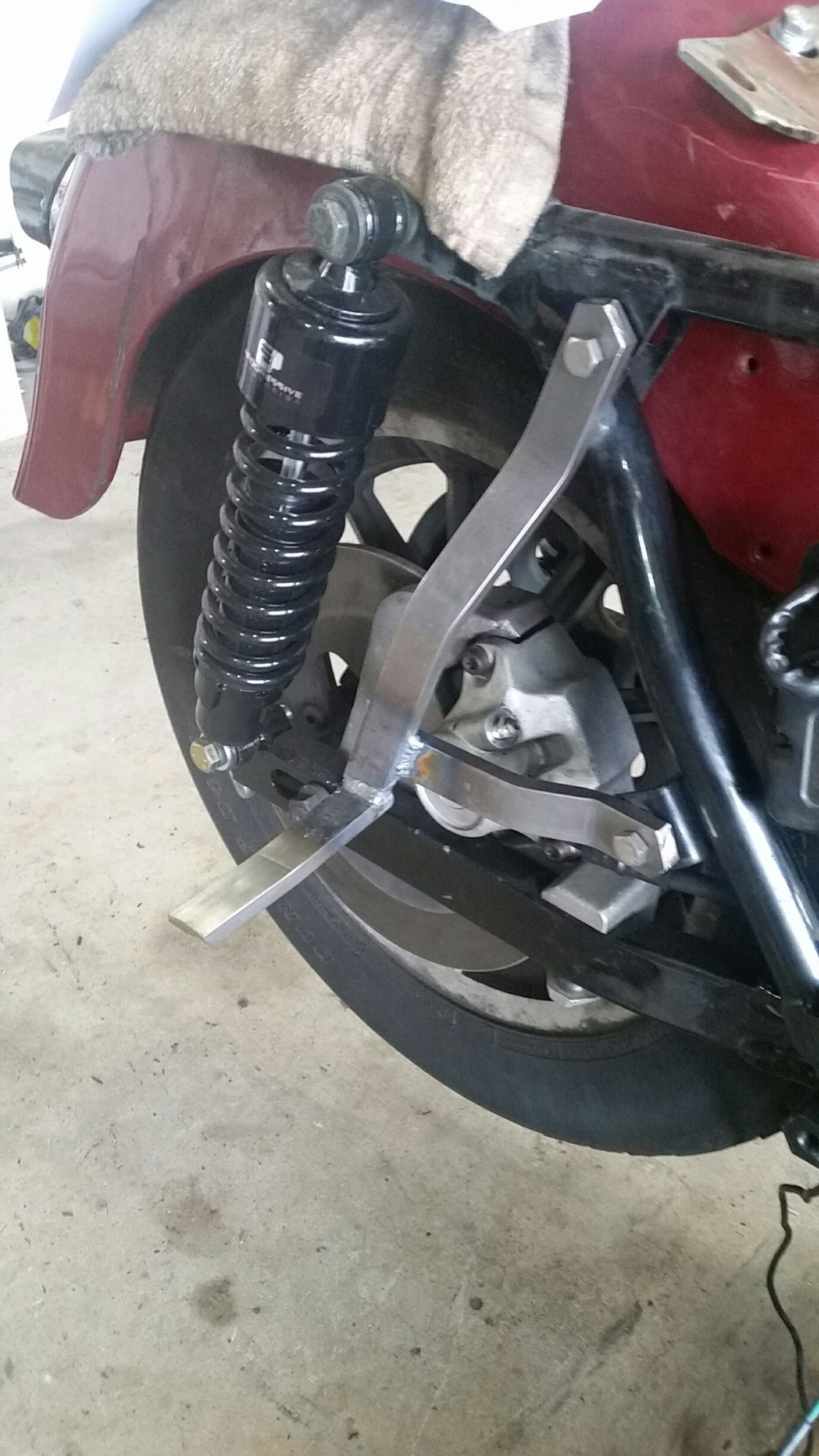

Put a couple dents in the project this weekend. Finished the wiring and got the Nacelle bolted up but forgot to take a pic.
Worked on the saddlebag mounts a bit. Long story short, I hate the current mounting. All that shoddy tubing all over the place, along with the damn crash bar in front of the bag, I can design better.
That's just the front.
How it looks mocked up, but upon deeper inspection those bags are getting tossed. They're in really bad shape, so I ordered some Hardstreet Kinger bags (google it). Tracking says I'll have them by Friday.
I also could never wrap my mind around how to fab the back saddlebag brackets, which will double as a rack mount for my Givi trunk, so F#@K IT, cut em' off and start from scratch!
