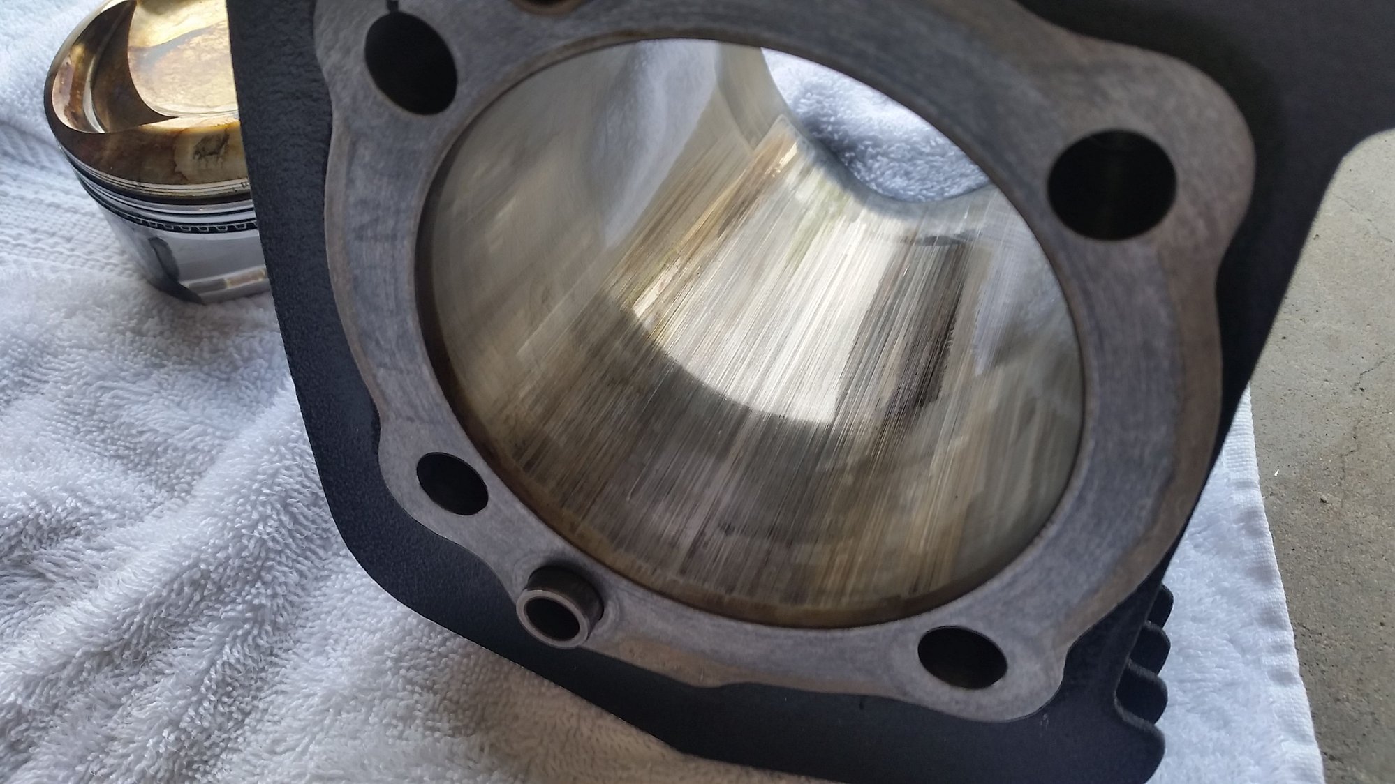

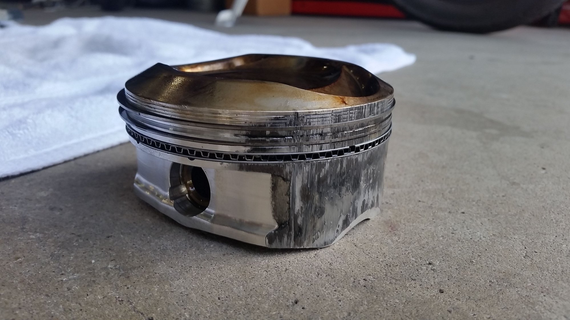

about 25 miles, got a weird idle knock. Kinda metallic sounding. Not sure if it's the huge valve lift and oversized valves breaking in or not. Developed over the ride.
Old Apr 7, 2018 | 07:08 PM
  #236
Mattbastard's Avatar
Mattbastard
Joined: Nov 2009
Posts: 4,315
Likes: 1,663
From: Tampa
Well this sucks:
Wideband NEVER said anything over 14:1, and I've got the timing set really retarded for break in. I know exactly where that happened too. Going about 50 in 4th towards the end of my outing, I slowed down a bit, then rolled on the throttle for a mild acceleration (varying RPM's, you know). As I was accelerating I felt a little dip in power, like when the carb starts getting air but I knew the fuel was good.
F#$K! Hopefully I can just hone that **** out and replace the piston. I'm sure the rear one is similar. That's the front, and the worst of it is on the rear side of the piston. Last time this happened to me it was the front of the piston.

Jump those jets up for the next one, running at 260 cranking 12.8 afr may be your safe place for a break in. My big engine never goes above 13.2 anytime and falls to 12.8 wot because sometimes normal just isn't for all engines.
