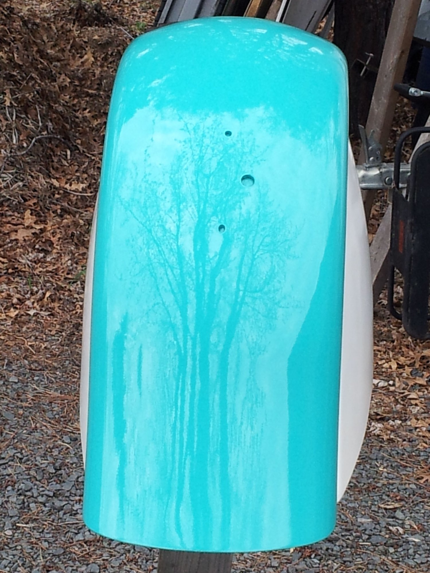

Was the 2 part clear SprayMax 2K ? I used it a while back and it works great, Folks will bust on you about using a rattle can but you can tell they've never used it by the crap they say. It works awesome and is durable for a driver, Will it give you a show quality paint job? Possibly, I haven't put that much effort into it. You can see the reflection of the tree behind me in the pic of the rear fender. Post up some pics of the paint job, looks good in the video..

Looks pretty damn good there rizzo....
good preparation is the key, I would think...
Yup, that's the stuff! Technically I wouldn't call it "rattle can" even though that's exactly what it is but rather a genuine acrylic enamel with hardening catalyst just like you'd mix up in a paint booth. The whole bike got three coats of it over the top coat. I got four cans and burned thru three of them over the whole bike.
I can say this, I needed to do a LOT better prep job on the surfaces I painted on to get a great looking paint job. The clear really makes it shine but if you look close you can see everywhere there's a small dent or somewhere I didn't smooth out the bondo perfectly.
