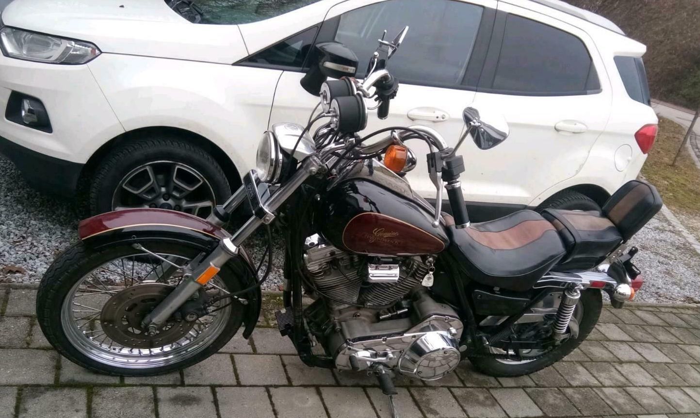

i know this is an older thread but just thought i would post to see if you will respond, i live & work here in Germany for 40 years now, but i still love American Iron !! i am currently looking at a 1984 FXRDG thats for sale about a hour away from me heres a few pix . . . any body have an idea what these are worth in original condition ?
she's 100% original according to the seller . . . the only thing i can see its missing 1 chrome fork slider dust cover . . . seller say he replaced the rocker cover gaskets . . .
according to the seller the turn signals were relocated on request of the original owner when purchased . . .
even has the original seat ,complete exhaust. it just has a funky medallion on the gas cap . . .

That's a really nice bike. It's hard to set a value on it. It would probably fetch at least $12,000 here in the Bay Area.
