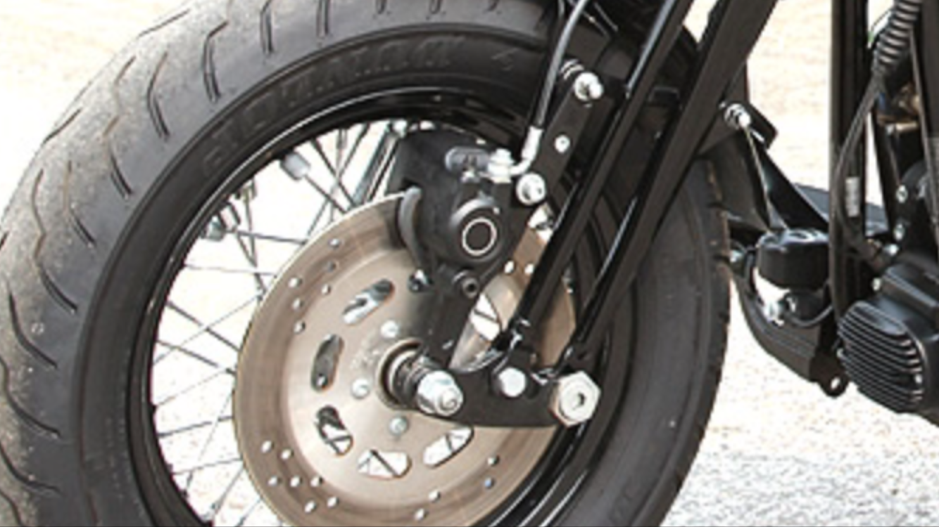

Can't take a picture, sorry took it back off to take to powder coat in the am...... But from the forks to the caliper is an adjustment rod, had to play with it till it lined up where I wanted it and it looked the way I wanted it to. also had to make a collar to fit in the hole on fender base and add a longer bolt to join it all together.

Used my immagination. Looked at the wife’s x bone didn’t help. She no got a rod like yours.

Thought all springers had this rod

Believe me if I could find away to loss this rod it would make my life a little easier but that is for another time.

From looking at pics of X Bone the rod is on the left side.

Okay I see yours, it looks to be a solid bracket...... Mine is adjustable. It opens from 4" to 6" from fork to caliper.

It looks like a X Bones still has the rod .... #13
But it's not adjustable .... had to reread your post before it sunk in.

Thanks, I have searching for a rod like that but could find anything close thought I would have to make my own.
